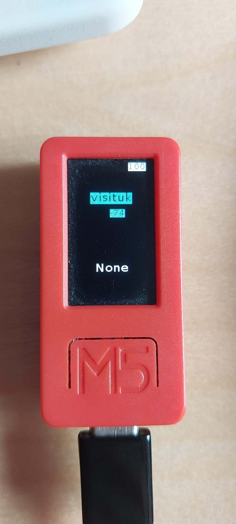

But now the screen was black again. Pushing buttons plays the different pitch beeps, and the screen shows some of the elements:
I have two of the sticks, same issue with both...
