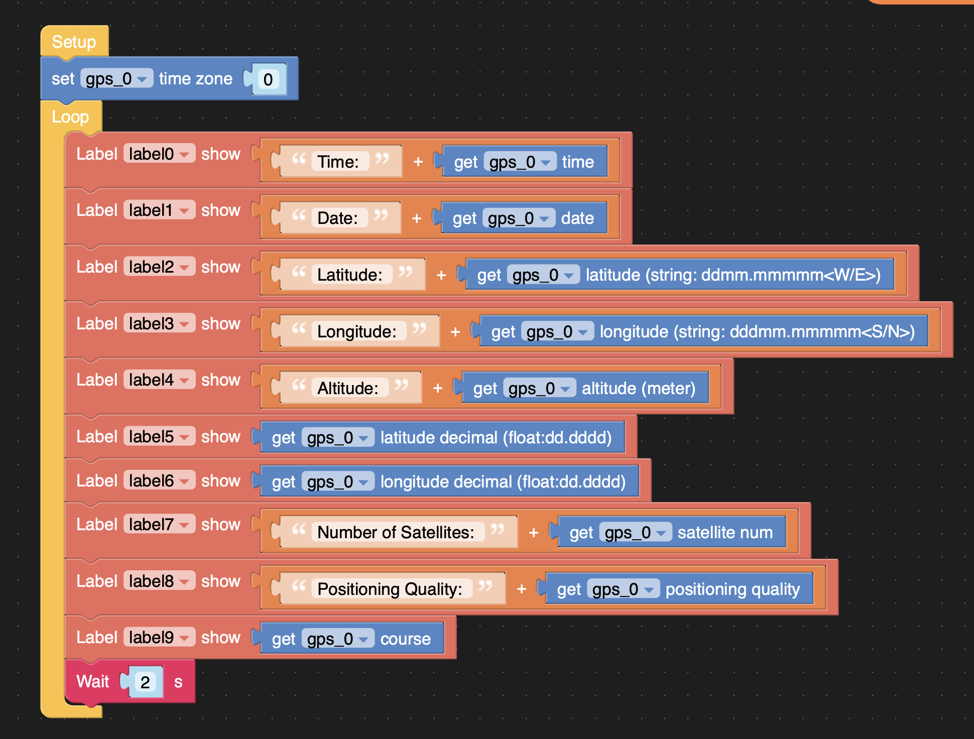

      When I run the following example:
      Latitude and longitude reading are flipped due to a typo in the blocks.
      The Latitude block says "W/E" but returns N/S while the Longitude says "S/N" but returns W/E.
