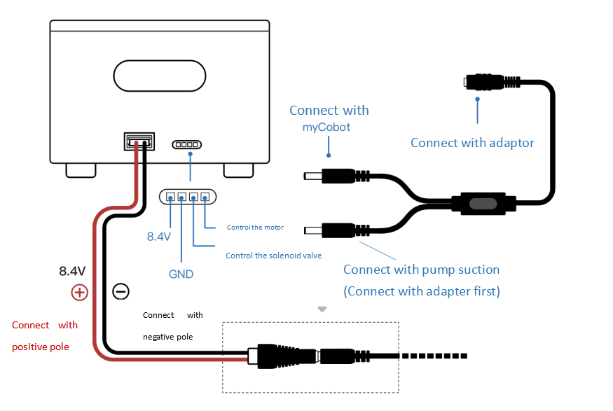

      Schematic diagram
      1)Female headline -- the power line end is connected to the port on the left side of the suction pump, the other end is connected to the outlet end of one and two lines, and the outlet end is connected to the power port of the mechanical arm, and the inlet end is connected to the power adapter.
      2)The pin end of Dupont line is connected (wiring diagram) to the annotating interface of the control motor and solenoid valve, and the other end is connected to the mechanical arm G2 and G5 pins (M5) 20 and 21 pins (Pi).

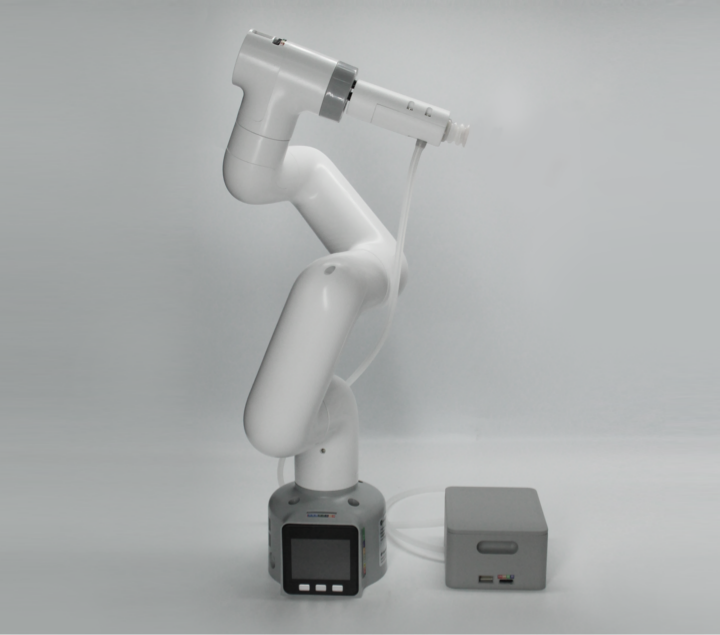

      3)The suction pump head was fixed on the end of the manipulator using LEGO technology.
      Installing the suction pump for myCobot280-M5
      1)Connect the suction pump pin to the Basic pin
      2)The solenoid valve control pin is connected to the Basic-G2 pin
      3)Pump control pins are connected to basic-G5 pin
      Installing the suction pump for myCobot280-Pi
      2)The solenoid valve control pin is connected to the Basic-20 pin
      3)Pump control pins are connected to basic-21 pin

      In the process of code running, myCobot will start working and we can monitor the state of motion of the suction pump. The maximum bearing weight of the suction pump is 200g.

      • J
        jkridner
        When using "myCobot 280 Pi - 2023", the voltage adapter is 12V, not 8.4V. Also, I purchased on Amazon and the power connections where screwed in reverse.
        Is there anywhere I can find better specifications on this pump?
