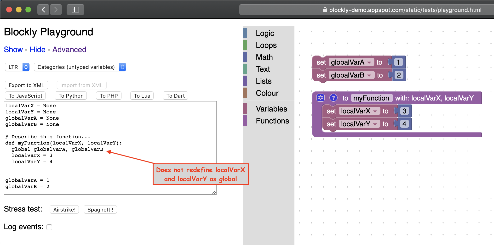

      Running the same function on the Blockly Playground, it seems to work correctly.

          Thanks for confirming. I think this is indeed a bug in uiFlow then. I shouldn't have to use the execute block to work with local variables in the functions. Especially if Blockly Playground behaves differently.
