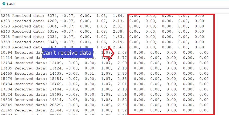

Hello @stackyarou it looks like the limiting factor is the MTU which by default is set to 23 bytes. I've tried to set a higher MTU on both sides using BLEDevice::setMTU(40);, but it did not help. I read somewhere that 23 bytes is the maximum for BLE 4.2 so maybe that is the reason? Thanks Felix
