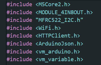

        To anyone trying something similar in the future
        MODULE_4IN8OUT module;
        MFRC522_I2C mfrc522(0x28, -1, &Wire);
        void setup() {
            M5.begin(true, true, true, true);
            Serial.begin(115200);
            delay(500);
            Serial.println("Starting setup...");
            M5.Lcd.println("Init...");
            // POWER MANAGEMENT dla Port A (RFID)
            M5.Axp.SetBusPowerMode(0);
            M5.Axp.SetLDOEnable(2, true);
            delay(200);
            // --- I2C BUSES ---
            Wire.begin(32, 33, 100000);
            Wire1.begin(21, 22, 100000);
            delay(100);
            M5.Lcd.println("Init 4IN8OUT...");
            // Start module 4IN8OUT
            if (!module.begin(&Wire1, 21, 22, MODULE_4IN8OUT_ADDR)) {
                M5.Lcd.setTextColor(RED);
                M5.Lcd.println("4IN8OUT INIT FAIL");
                Serial.println("4IN8OUT INIT FAIL");
                while (1) delay(1000);
            M5.Lcd.setTextColor(GREEN);
            M5.Lcd.println("4IN8OUT OK!");
            Serial.println("4IN8OUT OK!");
            M5.Lcd.setTextColor(WHITE);
            // Init RFID
            mfrc522.PCD_Init();
            M5.Lcd.println("RFID OK!");
            Serial.println("RFID OK!");
