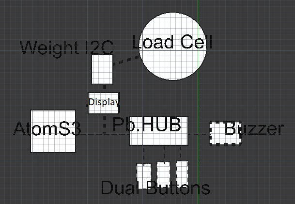

      Hello I'm totally new with M5 stack products and program it.
      I have the following case:
      M5 Components:
      (-Load cell)
      -AtomS3
      -Weight I2C
      -(Display) could also use the display of the AtomS3 but that's small ;)
      -Pb.HUB STM32 F030 1-6
      -Buzzer
      -3x Dual Button
      The 3 button's are for 3 different options:
      1 When button 1 is pressed when you slowly put pressure on the load cell it should make a buzz sound when 250kg is reached than there must start a timer of 2 minutes when it's finished buzzer must buzz 2x then the load must turned off.
      2 When button 2 is pressed when you slowly put pressure on the load cell it should make a buzz sound when 200kg is reached than there must start a timer of 2 minutes when it's finished buzzer must buzz 2x then the load must turned off.
      3 When button 3 is pressed when you slowly put pressure on the load cell it should make a buzz sound when 150kg is reached than there must start a timer of 1 minutes when it's finished buzzer must buzz 2x then the load must turned off.
      Is this possible with these products?
      I have asked AI the question and there was the following answer: The Weight I2C unit must have a direct connection with the AtomS3 otherwise it doesn't work?
      My thoughts than where use a Y-Cable to connect the Weight I2C unit and the Pb.HUB STM32 F030 1-6
      I'm happy with your advices
      Thank you :) Job from The Netherlands
