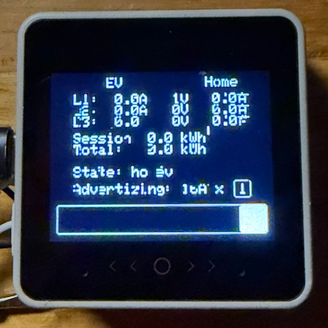

      but i found out that not flashing the CoreS3 and just connecting USB-C for power (and logging) i get a somewhat scrambled display.
      i have chatted quite a bit with the M5Stack AI chat but it is still not fixed. everytime i just connect USB-C it is a bit scrambled. re-flashing the same code give a nice and clean display. what is going on??

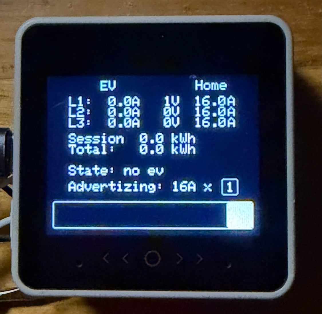

      here is a "scrambled" picture:
      and this after reflash:
