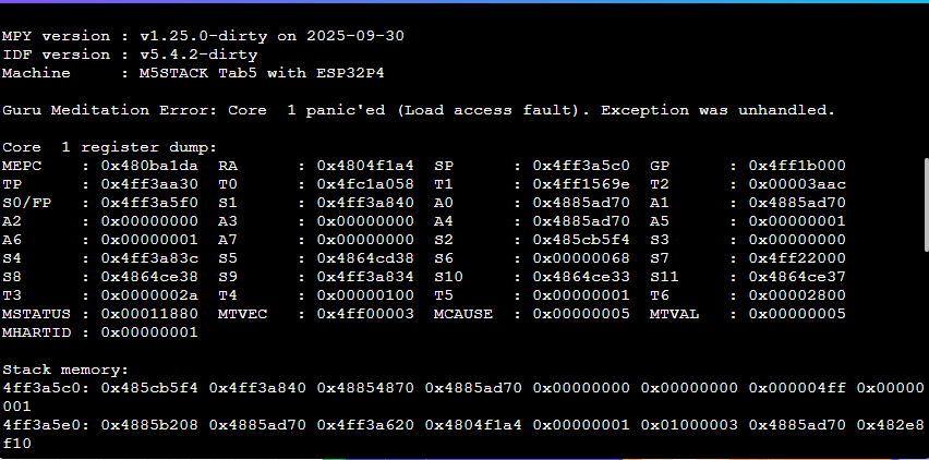

      I was trying to write an output on EXTIo2 and I got a python crash and a dump.
      I then tried to update the TAB5 to V2.3.6-hotfix2.
      The device programmed and the default UIFlow screen is showing, but now I cannot program the device.
      I reverted to 2.3.5 and I can program the TAB5

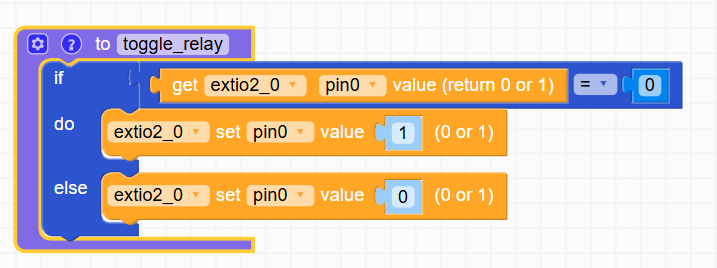

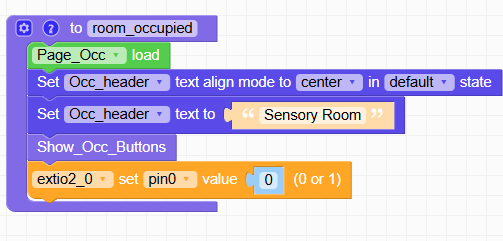

          Thanks Felix, I updated the TAB5 to V2.3.6-hotfix2 but the problem remains. As a trest I write once a second and that works, when I then call it in another function it panics
          This code panics
          This code works
          Any help would be appreciated
