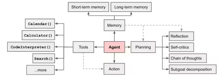

      What's AI Agent?
      An AI Agent is an intelligent entity capable of perceiving its environment, making decisions, and executing actions. Its functionality is based on large language model (LLM). However, unlike directly conversing with an LLM, an AI Agent can independently think, utilize tools, and gradually complete given tasks. Depending on the developer's skill level, it can accomplish various specialized tasks.
      In this case study, we will build a simple single-agent system based on the DeepSeek large language model. The execution logic is straightforward and consists of the following steps: Definition + Observation + Thinking + Action + Memory.
      Since an offline LLM lacks internet retrieval capabilities, it requires data input for learning. This ensures that whenever we activate the Agent, it is already prepared to assume its designated role and has sufficient knowledge to answer our queries. During usage, it will record user-approved responses, store them in a database, and continue learning from them.

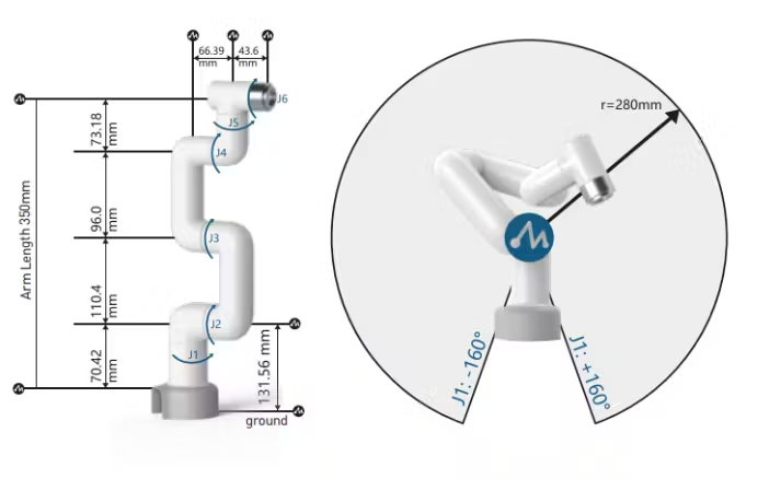

      myCobot 280 M5 Stack
      The myCobot 280 series, created by Elephant Robotcs, represent a line of 6 DOF collaborative robot arms designed primarily for personal DIY projects, education and research applications. The myCobot 280 , equipped with a M5 Stack as its control board, it has full Python API for easily control, which is designed to be user-friendly and easy for beginners to learn and use.

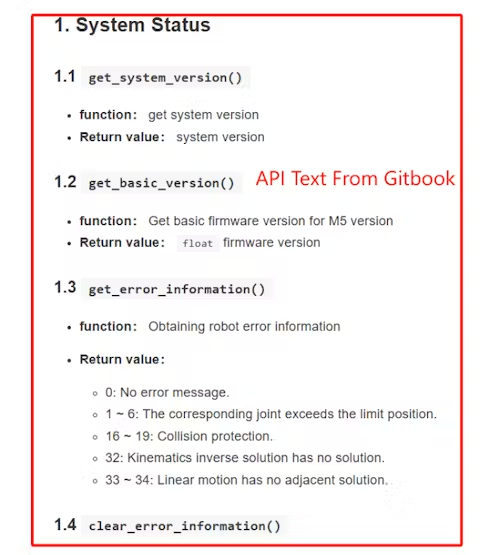

      We save the following information as separate DOCX files:
      ● Introduction to myCobot
      ● Technical details of 6 DOF collaborative robotic arms
      ● Usage instructions for the pymycobot API function library
      (These resources can be found on myCobot’s GitBook.)
      For example :
      Save the reference text as '.docx' documents.

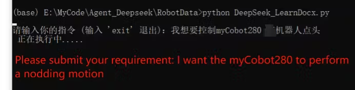

      5. Test with Robot
      By adding a while True: loop to the execution process, we can continuously run tasks.
      At this point, we have successfully built a simple AI Agent to control the myCobot robot. We can now connect the robot and test its functionality.

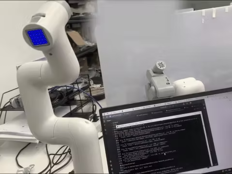

      By building a simple AI agent to control the 6-axis cobot myCobot 280 Pi, we have learned how to create a basic LLM-driven robotics application.
      Since this version of agent task does not include additional vision models, speech models, or sensors, it can only perform simple actions. However, if developers integrate vision, speech processing, and sensors, the AI Agent can autonomously complete more complex tasks.
