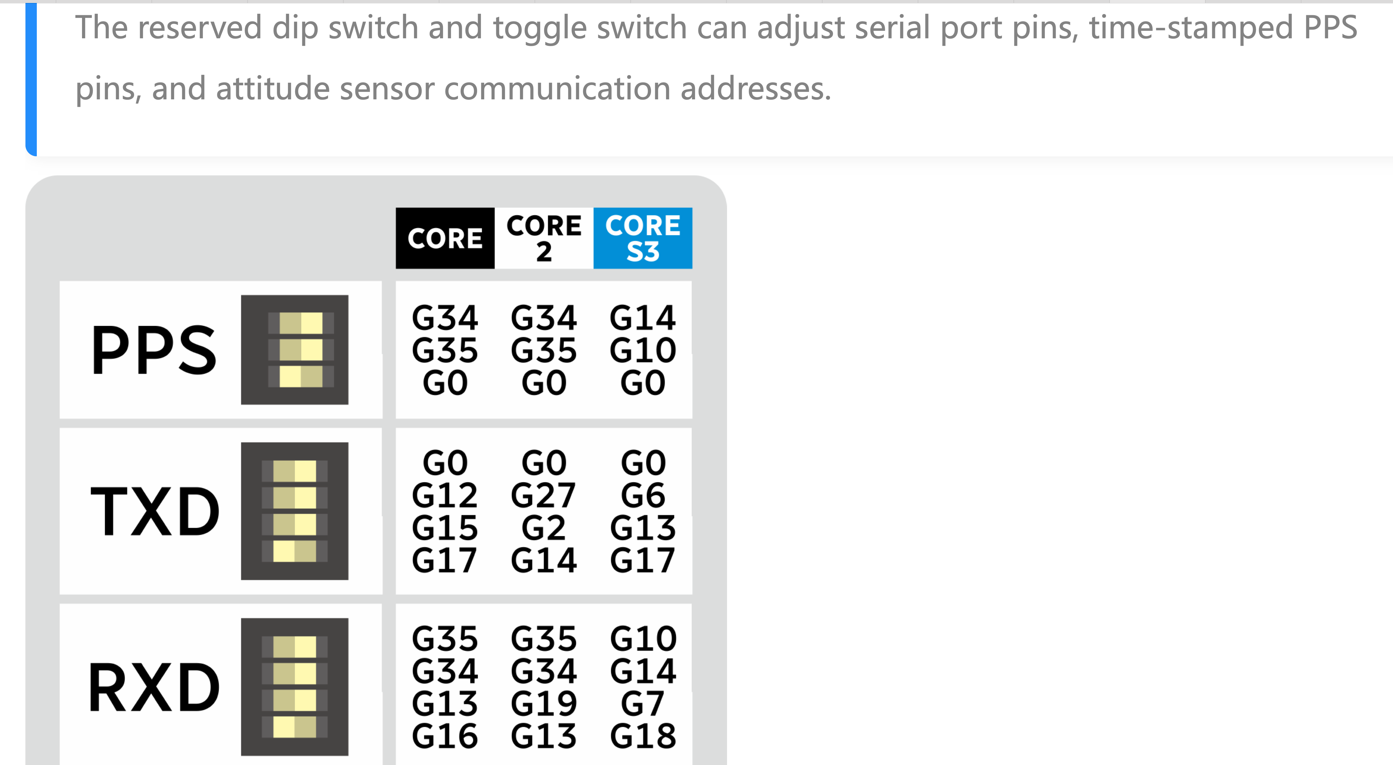

      Hello,
      can you please explain this documentation for DIP switches settings on GNSS module? How I can set it for the Core 2? DIPs are 0 or 1 but table has 3 columns.
      Thank you

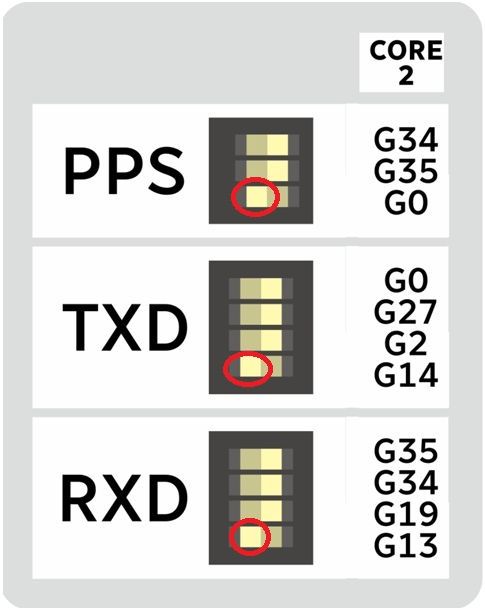

        @oldrichsveda
        Cheers, Terry!

        • ajb2k3A
          ajb2k3 @oldrichsveda
          @oldrichsveda Read the heading at the top of the columns.
          First column is for the Core, middle column is for the Core2 and the third column is for the Core 3.
          It is quite self explanatory.
          • robskiR
            robski @oldrichsveda
            @oldrichsveda
            by looking on the CORE2 table you can see that selection of gpio is :
            PPS enabled dip is for G0
            TXD enabled dip is for G14
            RXD enabled dip is for G13
            so to connect PPS/TXD/RXD you need G0/G14/G13

            • teastainT
              teastain @robski
              @robski good! maybe THIS will help?
              Cheers, Terry!
