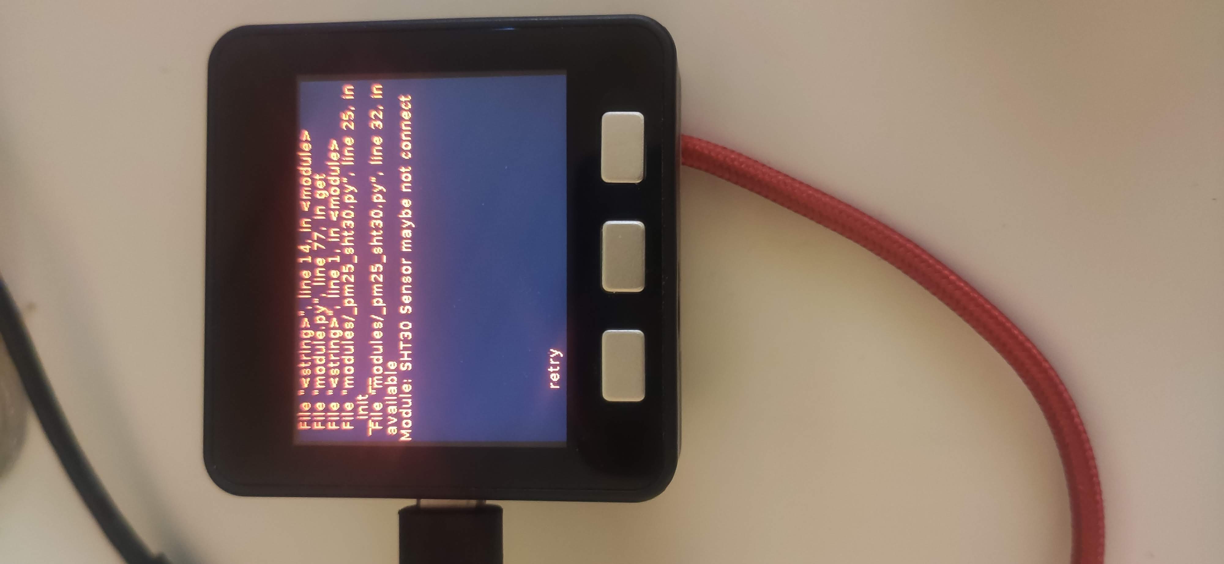

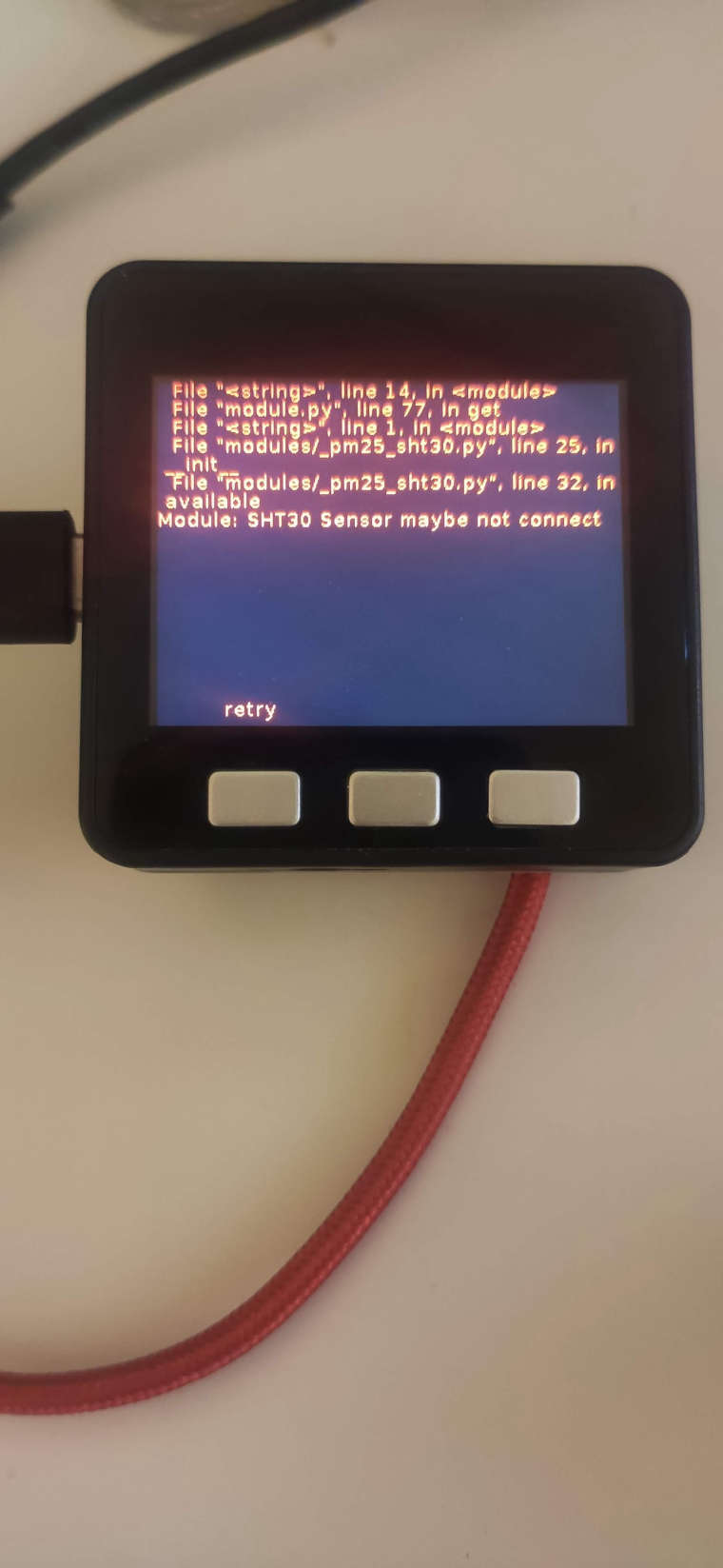

      I wanted to run the PM2.5 Module on my Core Basic.
      But whenever I try to start it it displays the erroe:
      SHT30 Sensor maybe not connected.
      Under Details it shows the following, see picture belwo:
      Version Log:
      Core Basic: V1.13.2
      UIFlow: V1.13.2
      Both USB are connected so power should be plenty.

        Yes, check that the PM base is securely fitted to the back and held with screws. If it isn't then the core can talk to the Pm2.5 and you get this error.
        Alternatively you have the older version with the SHT20 and I have already complained to M5Stack about it.

          The PM2.5 module is new and is labled with PMSA003 as far as I could find information it would be the SHT30.
          I also can't find that it wasn't connected correctly. It was pushed all the way in and secured with screws.
