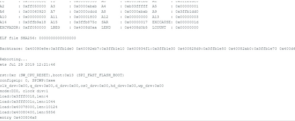

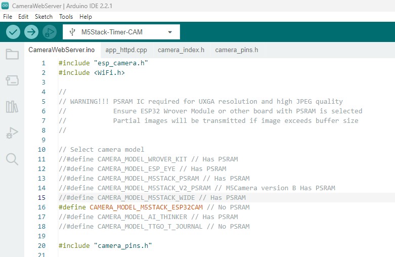

      1: I have flashed code ““File > Examples > ESP32 > Camera > CameraWebServer”” & it is showing error as in attached images.

        the board in your link seems to have PSRAM but in the code the selected model has "No PSRAM".
