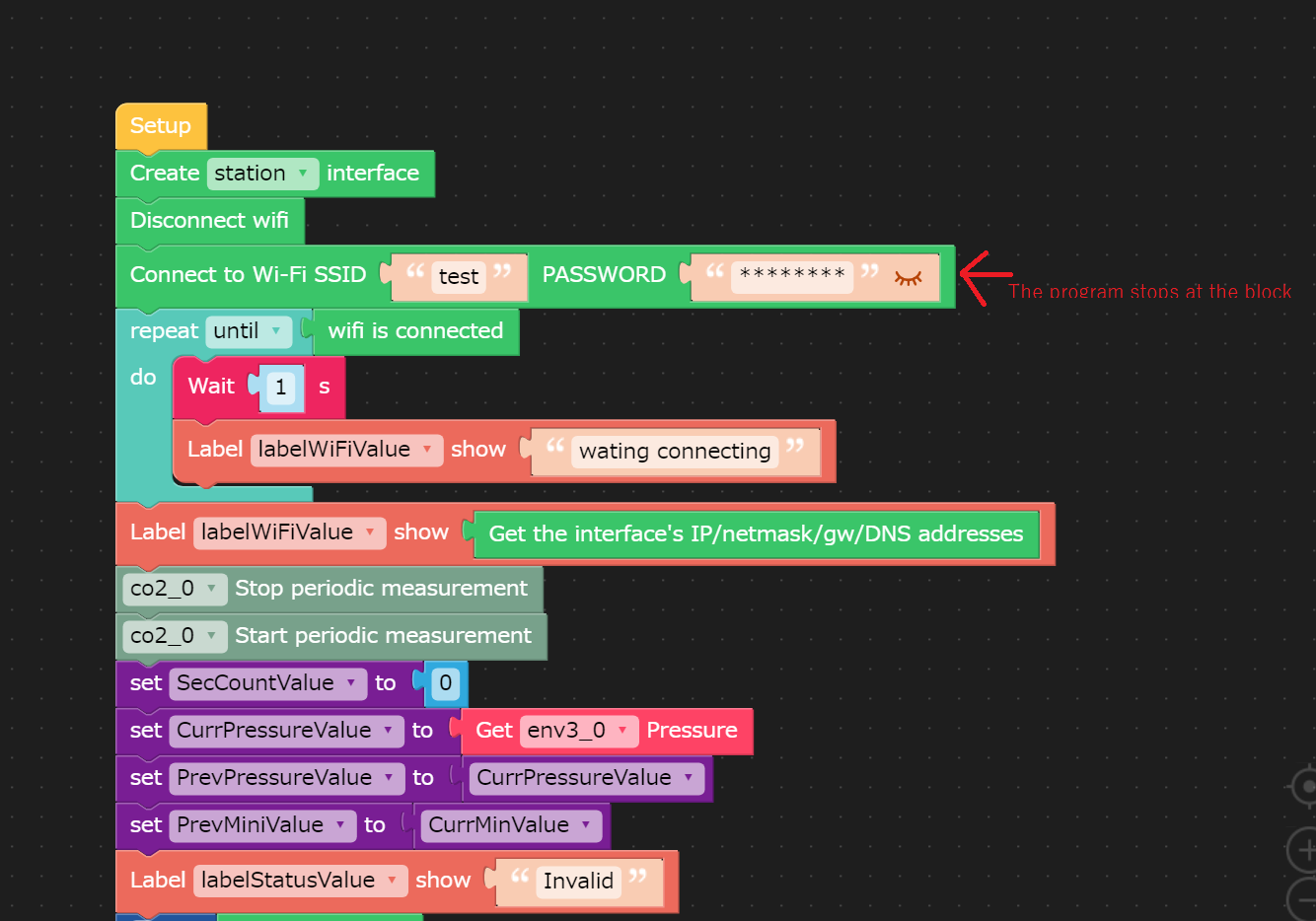

      I call the UT Flow block, ”Connect to Wi-Fi <ssid>” PASSWORD <password> , so it doesn't return to my program. So, my program have freezed. The example provided by you work right and freeze my program.
      I would know the correct full example for connecting Wi-Fi.

        Without seeing you program its hard to tell but I did check yesterday and the connect to wifi was working on a core2

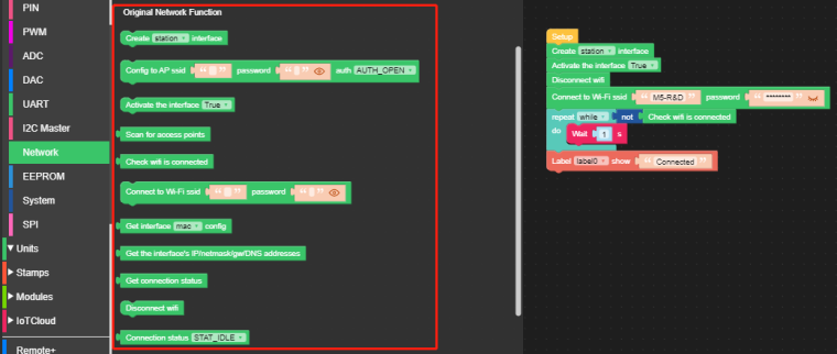

            My program may work right for connecting Wi-Fi, by modifying my blow program with UI Flow.
            alt text
            I find it strange that the block "Connect Wi-Fi SSID" does not work. It seems that the Wi-FI connection used by UI Flow has priority.

              • Please use these blocks. It is an original network(import network) function blocks
