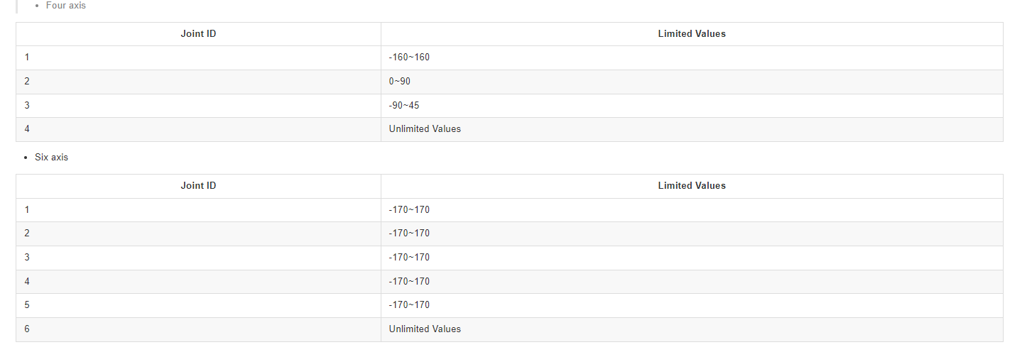

      degrees: (List [float]) contains the angles of all joints. A six-axis robot has six joints, so the length is 6; and the four-axis length is 4. The representation method is [20, 20, 20, 20, 20, 20]; value range: about -170 - 170. Each joint of the four-axis robot is different. See the table above for details.

      Note: When setting the Angle, different mechanical arms have different corresponding values.
