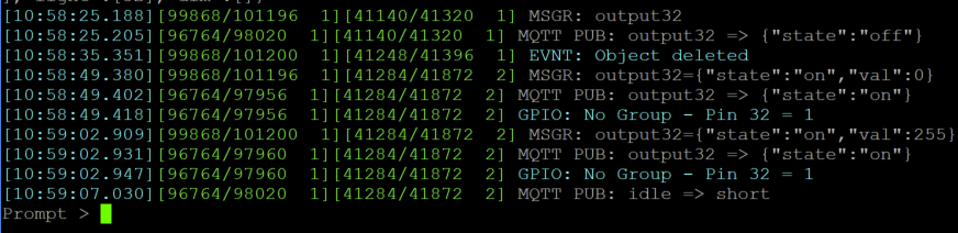

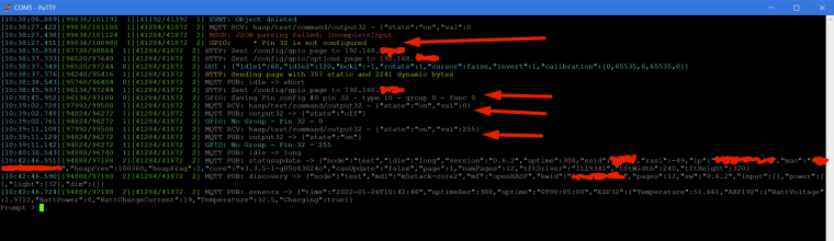

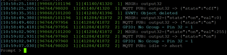

I've used the LED and relay before in UIFlow and have seen them work just fine. In fact I have a number of M5 Core2's in use with relays and leds right now. I am testing on the AWS version, while the others are normal, but I thought the only difference there was the AWS chip?
I've not tried connecting through a terminal program before. I'm assuming I need to turn on the debug stuff and just use putty to connect? (Not currently able to try; at work).
First arrow: every now and then it crashes and loses the GPIO config.
Otherwise these read to me as normal messages?
I tried sending the on/off through serial as well, also no effect. Tried adding a group, also no effect.
Now this is interesting: after I tell it through serial to reboot it starts on off AND the light is off.
I can turn it on, but after that I can no longer turn it off :S.
I see the same if I do the reboot and "on" from MQTT.
So positive: it appears that it can control the relay to some extend. But how do I get it to turn off and how do I regain the ability to change the state?
