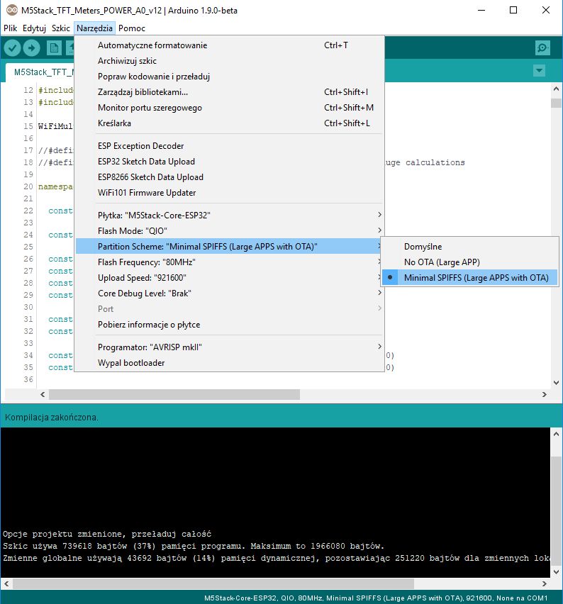

      Finally we can choose partition scheme for M5Stack board in Arduino IDE.
      It means that for large application (for eg. with bluetooth stack),
      that exceededs the maximum flash size for the default partition scheme,
      we can choose two others partitons "no ota" or "minimal spiffs".
      https://github.com/espressif/arduino-esp32/pull/1382
      https://github.com/espressif/arduino-esp32/pull/1302
      maximum sketch size for partitions:
      1310720 -> default
      2097152 -> no_ota
      1966080 -> min_spiffs
