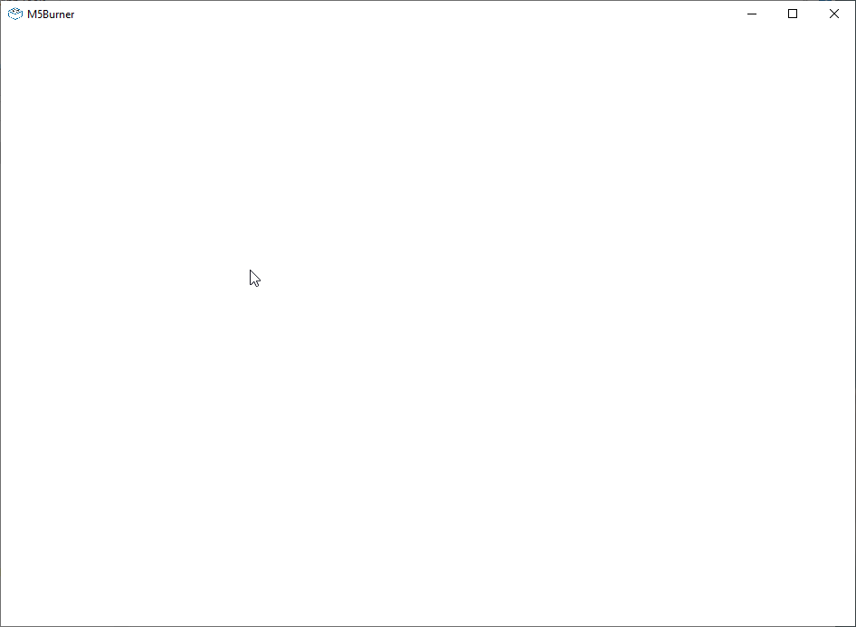

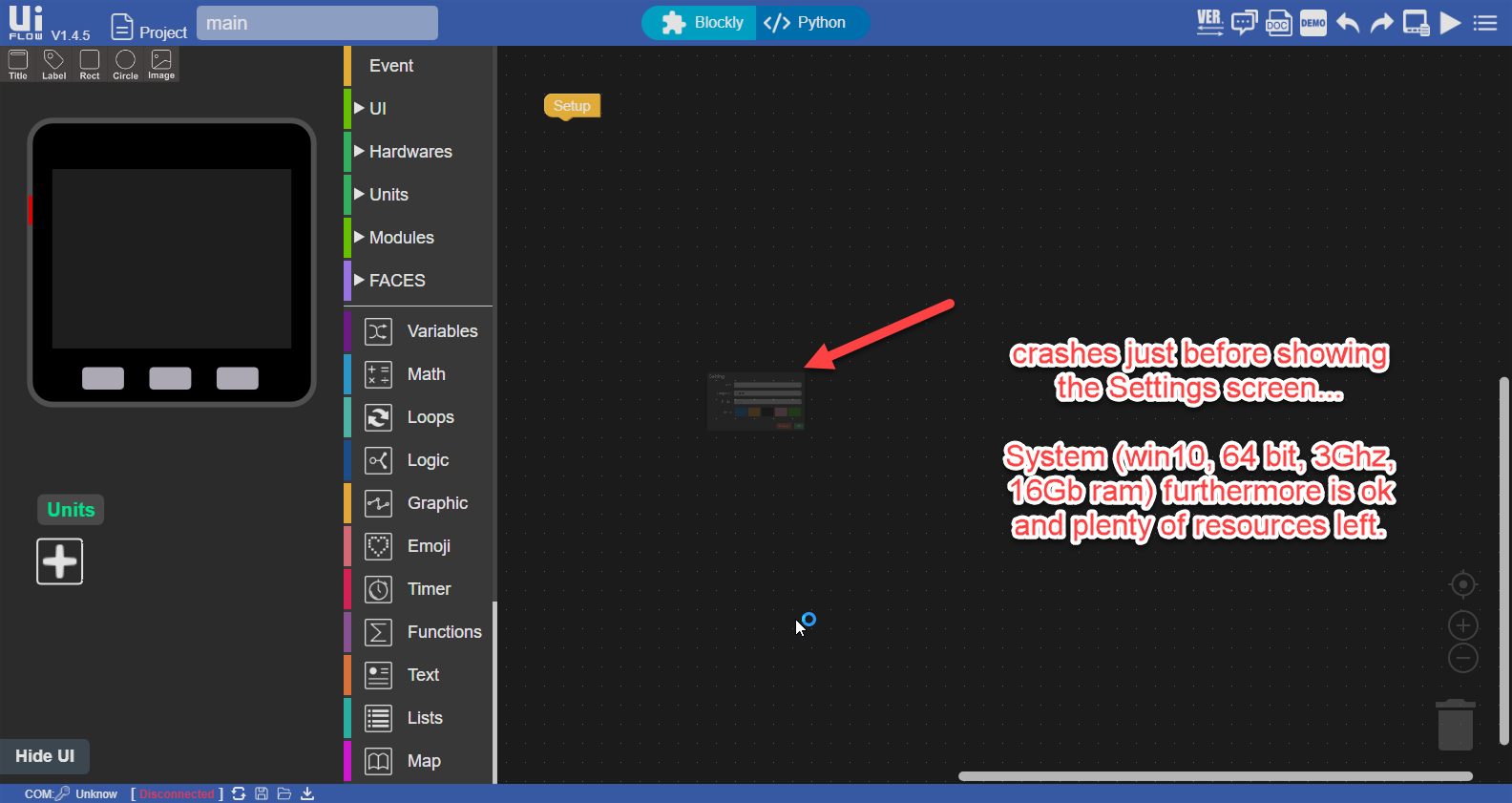

      Hi Guys, I'm new to M5stack and I'd like to build some code to play a video from the device triggered by an I/O. Nice idea, but so far I'm getting kind of frustrated because the IDE I've downloaded crashes right before it shows the setup screen.!! I've tried to disable anti-virus/firewall, removed node-js (might interfear) but nothing seems to help. What to do? Anyone?

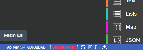

      Secondly I tried to use the webIDE. After entering the APIKEY, it complains the device is disconnected...0_1588339426306_M5disconnected.png
      I do see the COM in the PC's device manager, but its connected and there is no problem here. Also I've installed the drivers and upload software.
      After clicking the reloading button there is a message on the top right:
      Connecting M5
      Upload code failed, maybe your device is offline check it and retry
      How to get working on this lovely device???

            Hi, i m new too on M5Stack... May I ask you if you installed Firmware with M5Burner ? If not you must do it. Chose 1.4 or 1.5 and fill the entry for your WIFI .
            Then just on the right of [Disconnected] you have a refresh button, try it , and again ..

                      I've downloaded M5burner for installing new firmware directly, but the .exe also won't run. I tried to disable all PC protection software, but no difference...

                        @spoetnic M5Burner needs to Be put in a folder called M5Burner before it will work.
                        I wonder if that is the same problem With UIFlow crashing at startup.
