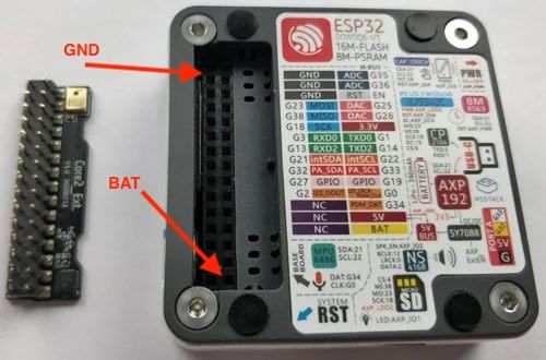

      Additionally, are those correct locations (as depicted in the picture)?

          @skyflyer said in External 1S LIPO on M5Core2 BUS PIN1 and PIN30?:
          I tried to find information about it, and want to confirm that it is OK to connect the external Lipo battery to pins 1 and 30 on the "BUS expansion port"? And that the battery will be charged when connected to the external USB power?
          If you look at the schematic you will see that pin30 on the bus and VBAT (on the lipo connector) are the same. So yes, you can replace the internal battery with an external one with the same voltage!
