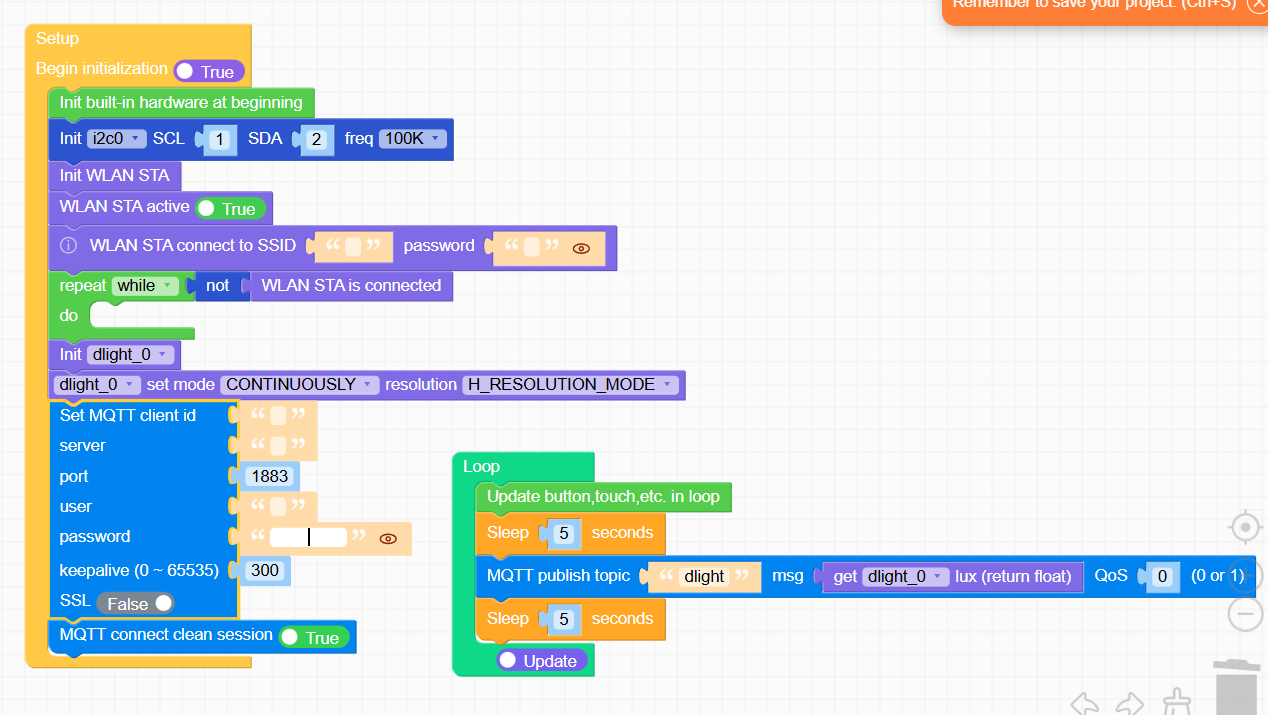

      Well this has been one of those projects where I have spent hours and got nowhere.
      Can anyone tell me why this UIFlow2 program is not working. By not working I mean I am getting no messages (light readings) published to my Home Assistant EMQT server.

        hmm, probably publishing doesn't work due to the delays in loop.
        Maybe this example in UIFlow2 Project Zone can help:
        M5AtomS3_WiFi_MQTT_UIFlow2.1.5
        Note: not tested again with latest UIFlow2.4.2. So it might not work anymore.
        Thanks
        Felix

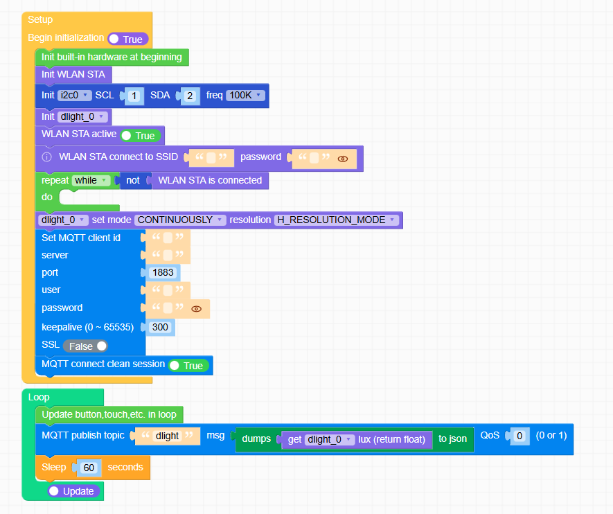

          Thank you felmue for your assistance.
          I have managed to get this working and the light readings are now passing through MQTT to my HA.
          I added the "dump (reading from the dlight unit) to json block" and all is working now.
