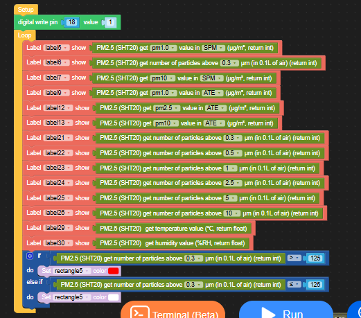

      Hello all,
      I'm want to use a pm25 kit to control my HVAC.
      Everything works fine untill i add a digital write pin.
      Sensors stop reading.
      What is wrong. I also put in some logic but deleted it to keep it simple. What is wrong with the digital pin? I put the digital pin in another program with a wait in it and cycle from 0 to 1 it just works fine.

        is pin 18 not used for internal I2C/SPI?

          You are right. I now use pin 33. All sensors keep updating.
