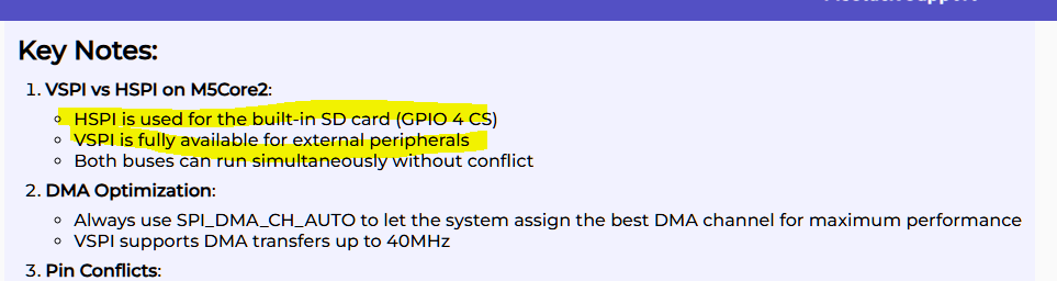

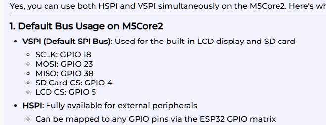

      So Id like to use another SPI tfor my externaly connected sensors (by extension board using M5bus). After using AI Chat here, I am more confused:
      this is the response to one question:
      and this to another question, which is, in my opinion, contrary to the response above:
      => So is VSPI or HSPI used (internally) for LCD/SDcard with pinout 18/23/38/.. ?
