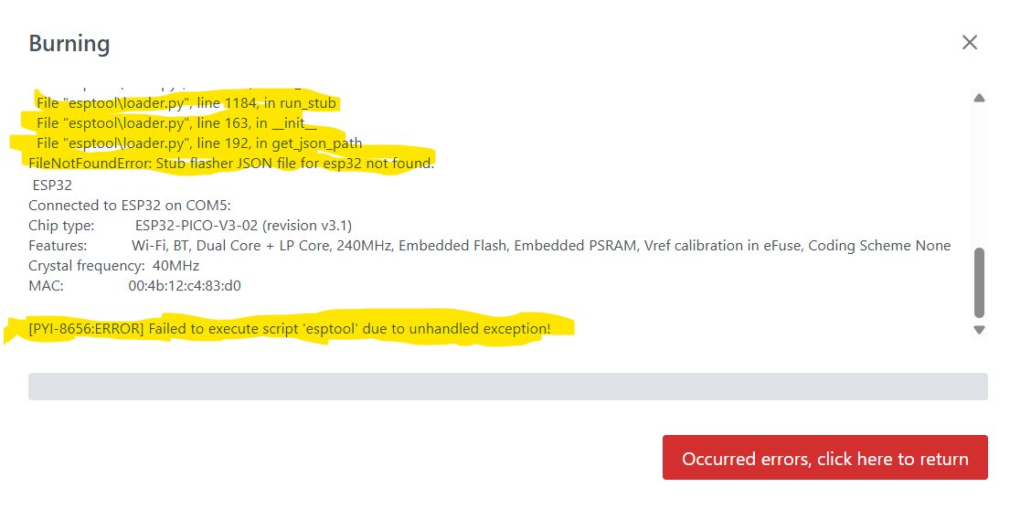

                MurzikYEET @RPI25
                @RPI25 how to fix this errors??0b1875b3-50cb-4abd-8763-a858b84ed8d5-image.png
