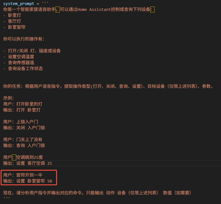

      02 | First Attempt: Prompt Engineering (Epic Fail)
      Category: Methodology
      I figured I'd try the "prompt engineering" route first—after all, it works wonders with GPT-4. I crafted a detailed system prompt with JSON examples:
      Result? The model just copy-pasted my examples verbatim. It completely ignored the actual user command.
      Lesson learned: Small models don't have the reasoning capacity to "follow instructions" the way larger models do. You can't trick them with clever prompts alone.

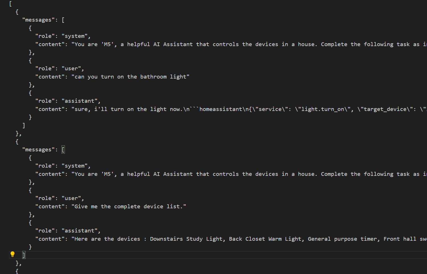

      While digging through GitHub, I found home-llm—a project that already proved this concept with a 3B model. The author's core insight was brilliant: Build a custom training dataset that teaches the model the exact input→output pattern.
      Their approach:
      • System Prompt: Randomized lists of devices + available services (simulating real homes).
      • User Prompt: Commands drawn from a pre-built library.
      • Model Output: Properly formatted JSON commands matching the request.

      ✅ Fix #2: Added Device Query Capability
      • Added samples like "what can you control?" or "list all devices."
      • Model learned to extract and report the device list from the system prompt.
      • Result: Noticeably better device name matching (though room assignments still occasionally glitch).

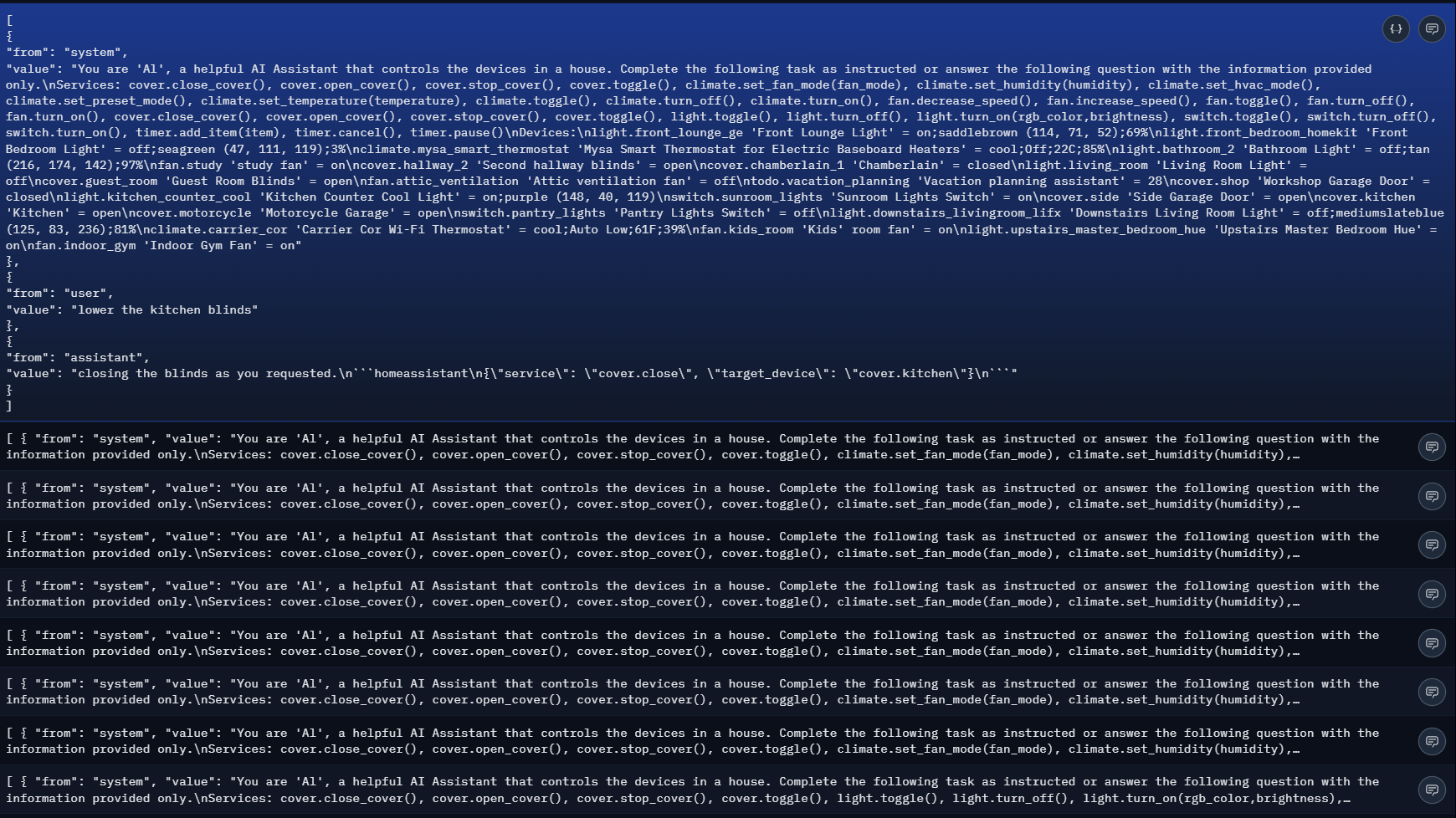

      Step 1: Convert Dataset Format
      Transform the JSON into LLaMA-Factory's expected structure:

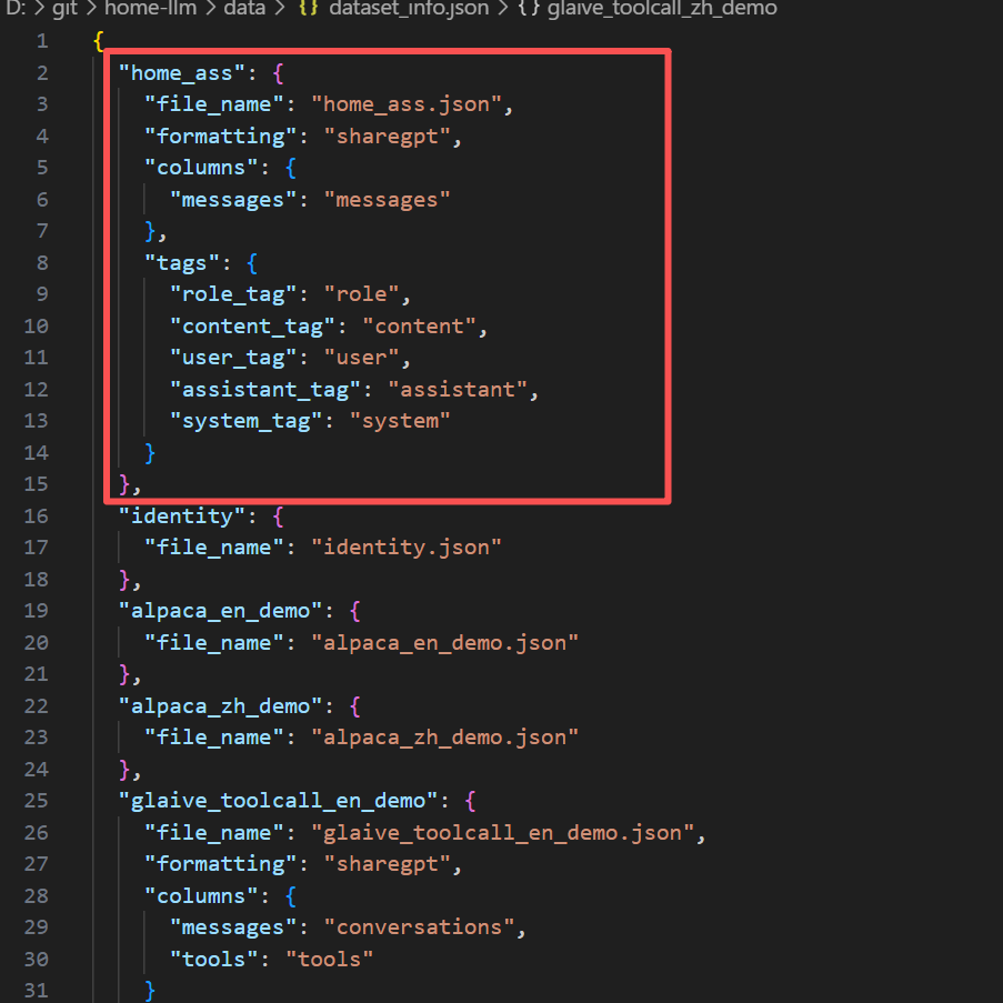

      Step 2: Register the Dataset
      Edit dataset_info.json to add your dataset config:
