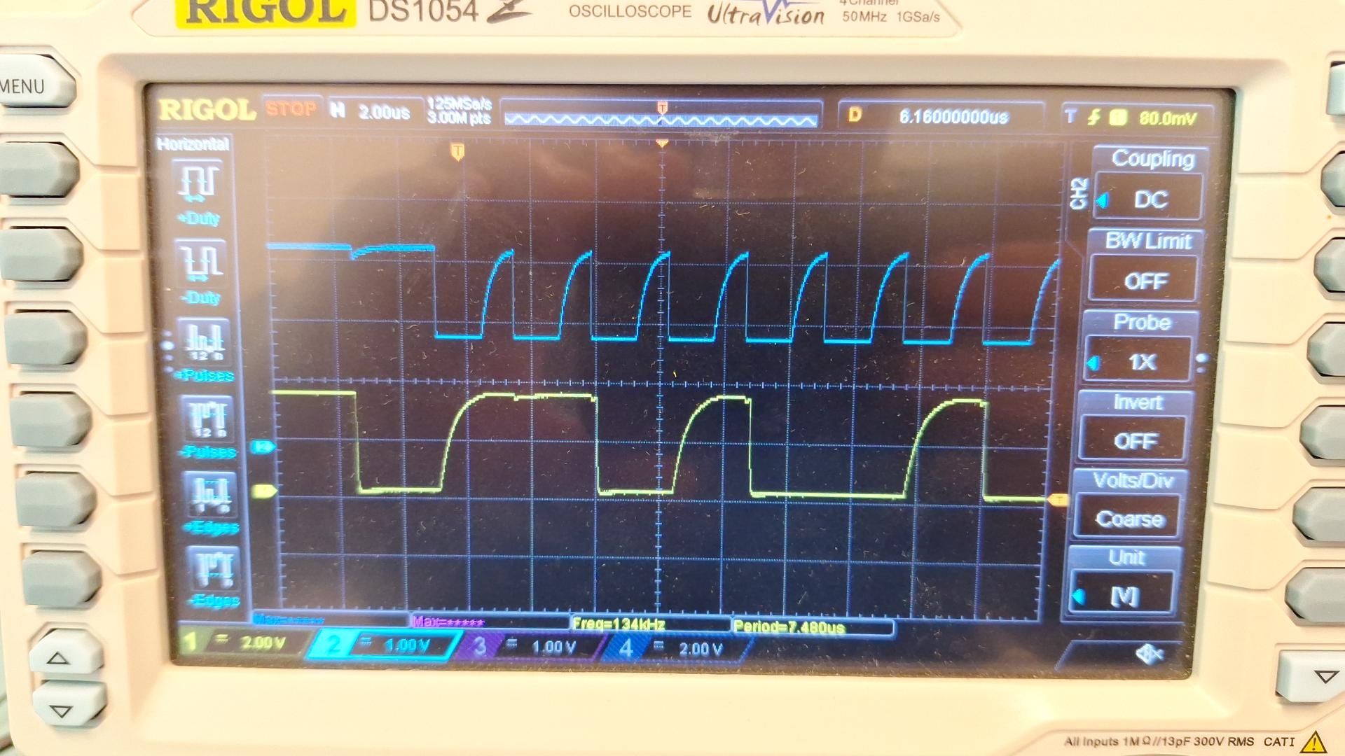

          We did notice shark fin like signals on the i2c lines on 400k. We reduced it to 100k but the results stayed the same. We do not believe that the bad signal quality is causing the current issue we are having. On a good working board the signals look identical.
          For reference, here is inmage of the signal quality of the SCL/SDA line on 400k speed on the good board.:

            I can confirm the shark fin like signals on my M5CoreS3. I am no I2C expert, but I think they might be marginal and so maybe just barely working on one M5CoreS3 but not on the other when talking to AXP2101. Maybe a stronger pull-up resistor might help?
            BTW: I checked the I2C SCL line on an M5Core2 and it is much more rectangular, e.g. much more like I would expect it.
