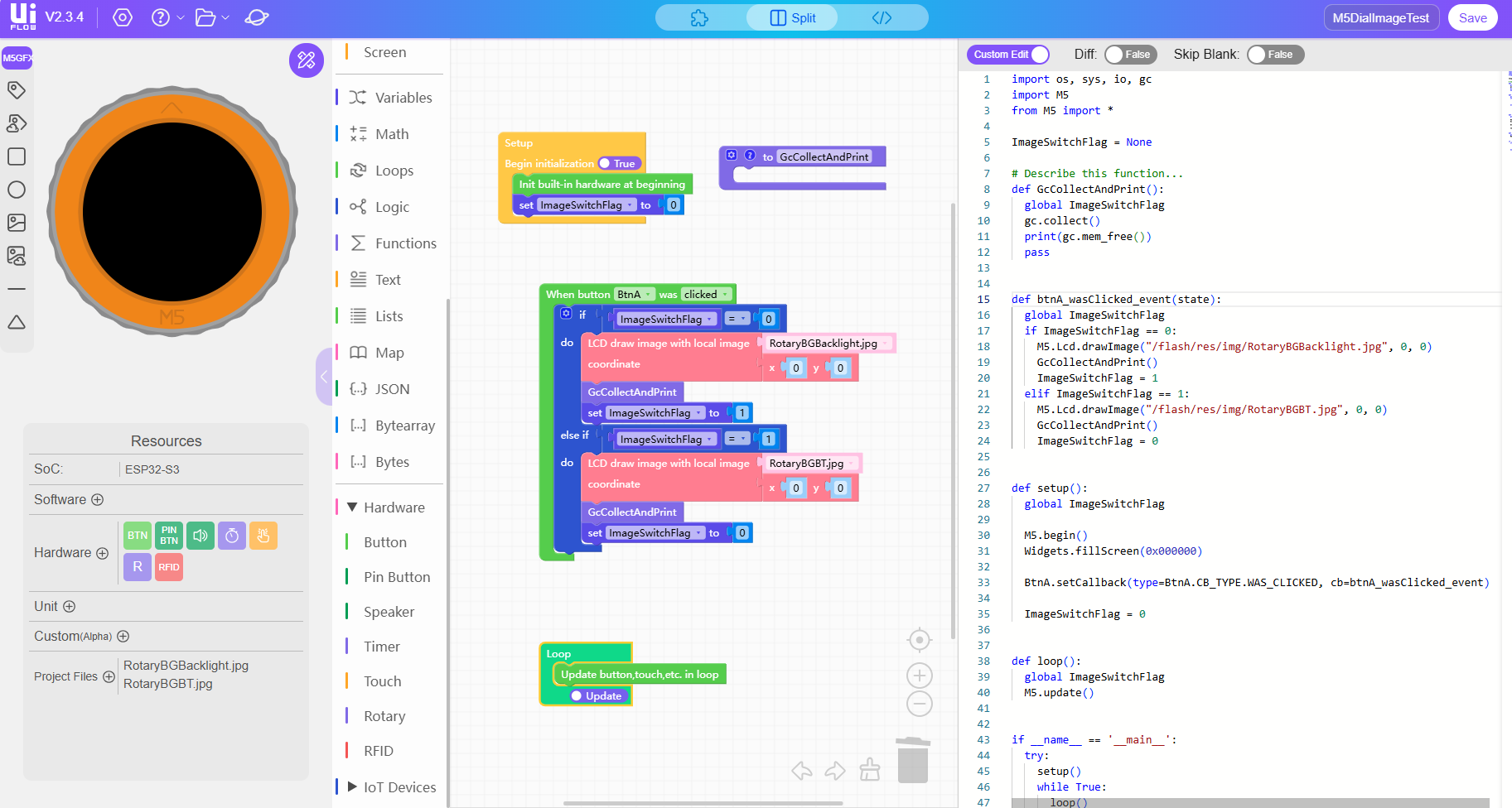

      我在UIFlow2.3.3里使用M5GFX实现最简单的图片切换,频繁切换后发现,图片无法再切换,但系统还在运行,只是不能切换图片,怀疑应该是图片组件崩溃了。我尝试用gc.collect强制回收也没有效果,gc.mem_free监测发现内存一直持续减少。以下是我的UIFlow设计和相应的代码:
      import os, sys, io, gc
      import M5
      from M5 import *
      ImageSwitchFlag = None
      def GcCollectAndPrint():
      global ImageSwitchFlag
      gc.collect()
      print(gc.mem_free())
      pass
      def btnA_wasClicked_event(state):
      if ImageSwitchFlag == 0:
      M5.Lcd.drawImage("/flash/res/img/RotaryBGBacklight.jpg", 0, 0)
      GcCollectAndPrint()
      ImageSwitchFlag = 1
      elif ImageSwitchFlag == 1:
      M5.Lcd.drawImage("/flash/res/img/RotaryBGBT.jpg", 0, 0)
      GcCollectAndPrint()
      ImageSwitchFlag = 0
      def setup():
      M5.begin()
      Widgets.fillScreen(0x000000)
      BtnA.setCallback(type=BtnA.CB_TYPE.WAS_CLICKED, cb=btnA_wasClicked_event)
      ImageSwitchFlag = 0
      def loop():
      M5.update()
      if name == 'main':
      try:
      setup()
      while True:
      loop()
      try:
      print_error_msg(e)
      except ImportError:
      print("please update to latest firmware")******

        已知问题,会排期修复
