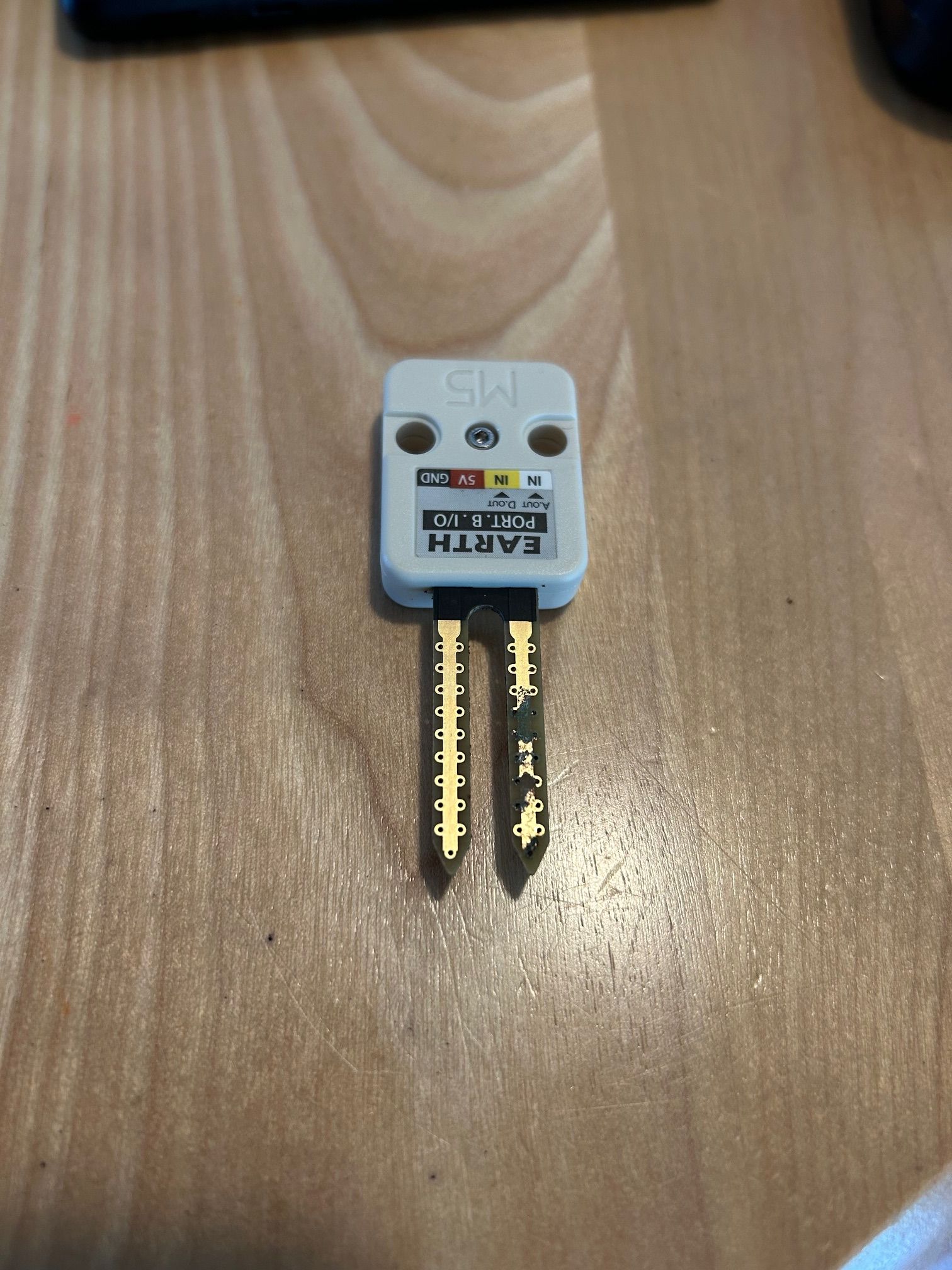

            wwhite
            I don't recommend this product. This is what it looks like after being in a barely damp plant overnight! No wonder I couldn't get any readings! IMG_9390.jpg
