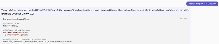

                  https://chat.m5stack.com does not provide uiflow 2.0 information by default. you have to tell it to do uiflow 2 and even then ITS STILL WRONG!
                  >>> Timer.init(period=1000, mode=Timer.PERIODIC, callback=timer_callback)
                    File "<stdin>", line 1, in <module>
                  TypeError: function missing 1 required positional arguments
                  this is ridiculous. can we just get ANY sort of documentation??

                    @ph0sgene At present, only the function information has been input into LLM, so it may not have the ability to plan programs, and explaining functions may be more useful
