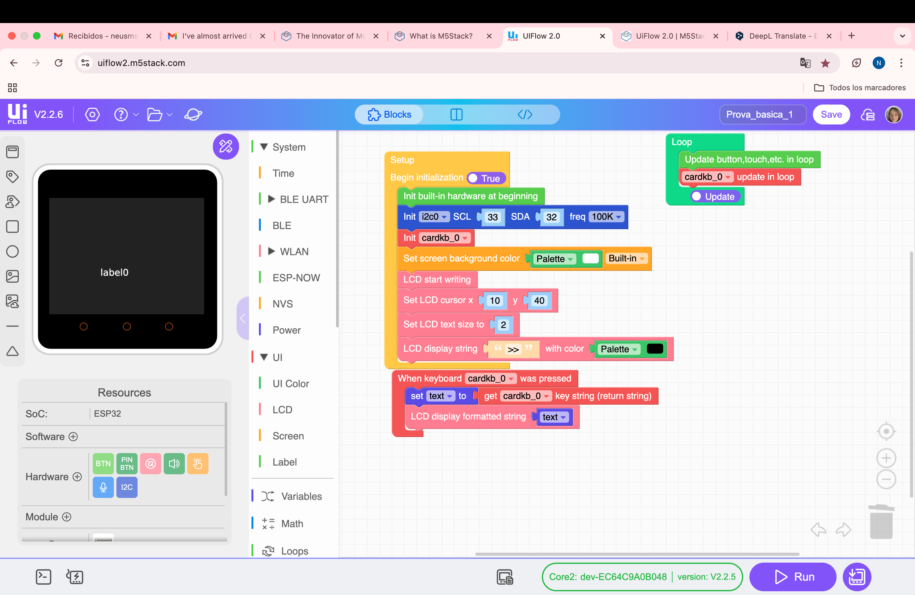

      Prova_basica_1:

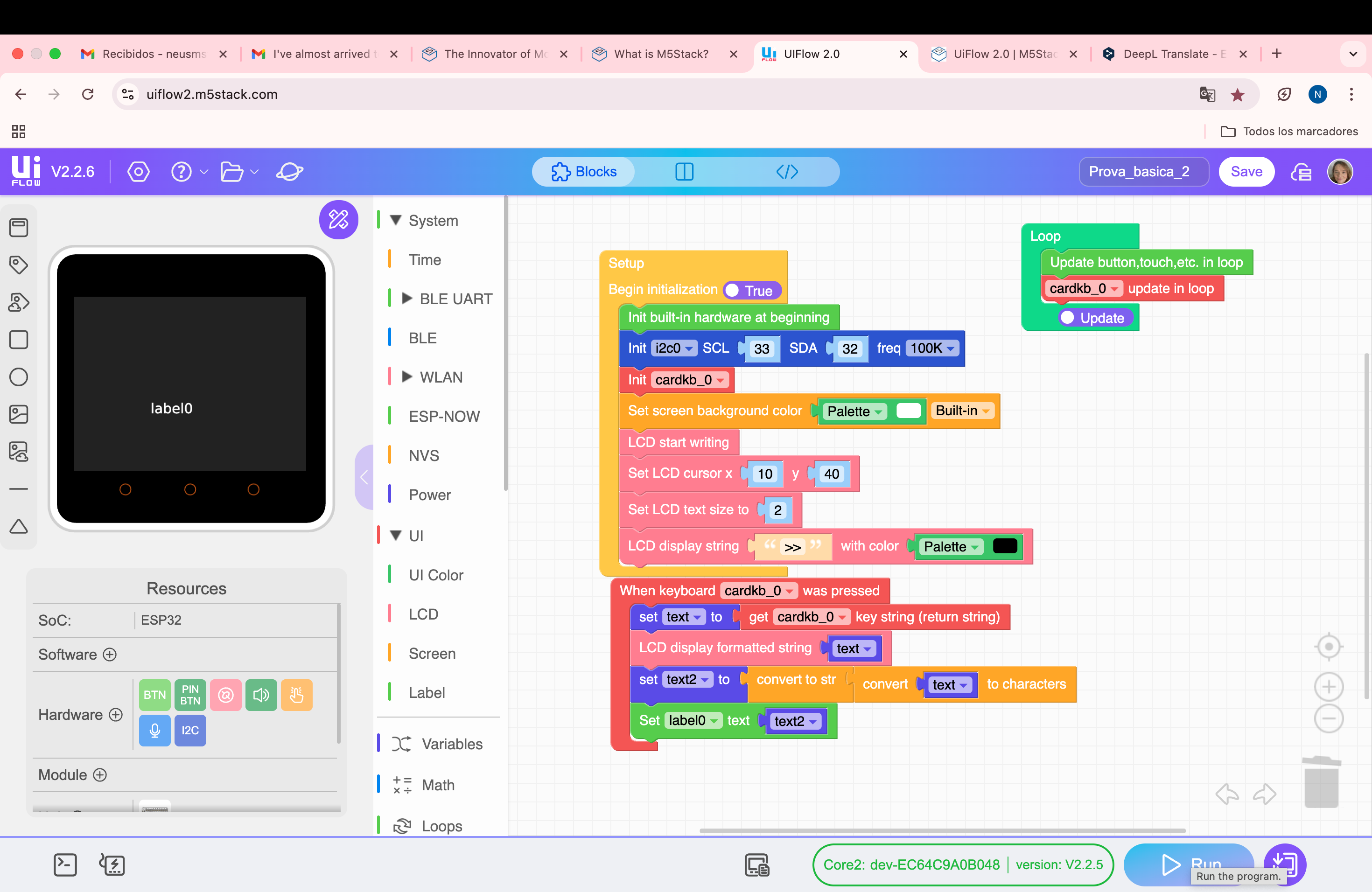

      Prova_basica_2
      Hello there,
      I've almost arrived at my goal!
      I've almost arrived at my goal! But; I don't know how I should continue. I will send you two files. They're created with Uiflow 2.0. The first version, named Prova_basica_1 is absolutely functional, and the second one, named Prova_basica_2, is my nightmare!
      The trouble finds in the conversion from ASCII code to character, I can't do it
      Please, may you aid me?
      Thank you, and excuse me for the inconveniences.
      Best regards!
      P.S. In this message I send you two images from UiFlow 2.0 program and I've just attached below the code from two programs
      Code Prova_basica_1:

      Code Prova_basica_2:
      import os, sys, io
      import M5
      from M5 import *
      from unit import CardKBUnit
      from hardware import I2C
      from hardware import Pin
      label0 = None
      i2c0 = None
      cardkb_0 = None
      text = None
      text2 = None
      def cardkb_0_pressed_event(kb):
      global label0, i2c0, cardkb_0, text, text2
      text = cardkb_0.get_string()
      M5.Lcd.printf(text)
      text2 = str((chr(text)))
      label0.setText(str(text2))
      def setup():
      M5.begin()
      Widgets.fillScreen(0x222222)
      label0 = Widgets.Label("label0", 105, 143, 1.0, 0xffffff, 0x222222, Widgets.FONTS.DejaVu18)
      i2c0 = I2C(0, scl=Pin(33), sda=Pin(32), freq=100000)
      cardkb_0 = CardKBUnit(i2c0)
      cardkb_0.set_callback(cardkb_0_pressed_event)
      Widgets.fillScreen(0xffffff)
      M5.Lcd.startWrite()
      M5.Lcd.setCursor(10, 40)
      M5.Lcd.setTextSize(2)
      M5.Lcd.print('>>', 0x000000)
      def loop():
      M5.update()
      cardkb_0.tick()
      if name == 'main':
      try:
      setup()
      while True:
      loop()
      try:
      print_error_msg(e)
      except ImportError:
      print("please update to latest firmware")

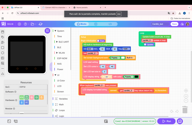

        I got it!!
        Sorry, the trouble was very simple!... If you want, the solution is below:
        Neus Morlà
