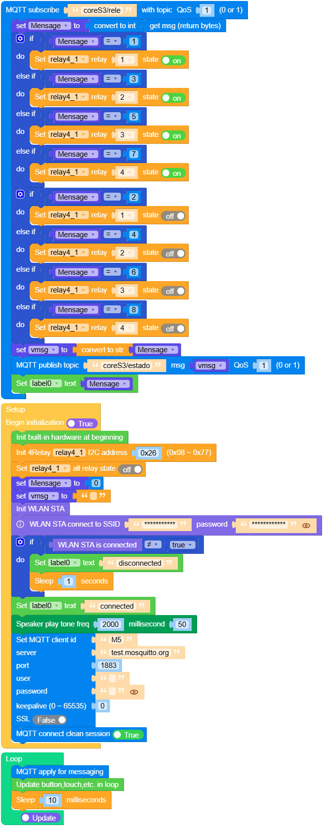

      I'm facing issues with both subscription and publishing in MQTT. When publishing, it does not allow me to send alphanumeric values. If I use a numeric string and then convert it to an integer, it works correctly, as shown in the following example:
      MQTT publish topic "coreS3/state", "5", Qos 1
      However, when I try to publish any variable, whether numeric or text, the system simply ignores the command without displaying errors. For example:
      MQTT publish topic "coreS3/state", numeric or text variable, Qos 1
      If instead of a variable I use a fixed string, the command executes without issues.
      I have spent a lot of time trying to solve this, but I haven't found a clear answer. Has anyone faced a similar issue or has any suggestions on how to fix it?

        hmm, using variables in MQTT publish works for me.
        How are you testing your code? Make sure your test software uses a different MQTT client id than your UIFlow2 code, else the first registered client gets kicked out.
        BTW: my example is in the Project Zone, named M5CoreS3_MQTT_4Relay_UIFlow2.2.5
        Thanks
        Felix

          @felmue Hello , Your code worked perfectly. I really appreciate the time and effort you put into helping me—it means a lot! Thank you!
          Roberto
