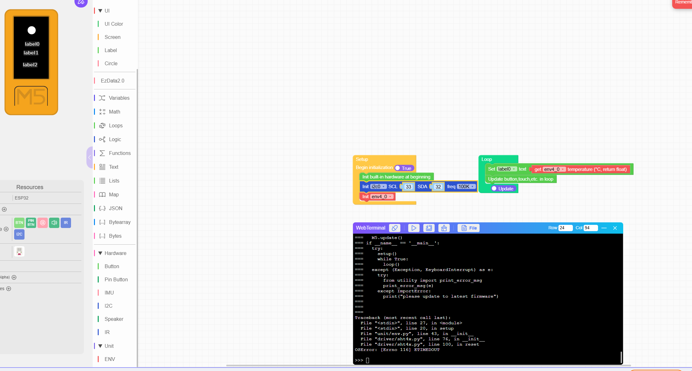

      I can't get my M5Stickplus2 to read any variables from my ENV IV. I've used the example and it doesn't work. Does anyone has a valid example that works? I'm wondering whether the ENVIV has a problem

        have you tried EasyLoader file for ENV 4 unit?
        have you tried Arduino example from ENV 4 documentation page? - Double check that I2C pins are correct

          Just try these module in uiflow1
          I have core-2 ,m5stickC and m5stickC Plus and an external IMU and a env PRO module
          Used them all with the same blocks in uiflow2 and uiflow1, Core-2 no problems at all.
          The sticks only work with these sensors in iuflow1.
          using the sticks with uiflow2 gives an i2c error (during uploading a red line flashes fast in a window) and the modules are not found, doing i2cscan returns an empty list.
          in uiflow 1 the modules work and i2cscan gives the correct i2c adresses
          M5stack makes beautiful hardware and shitty software. Thinking now of throwing all these junk just in the electronic recycle bin.
          kurikoK 1 Reply Last reply Reply Quote 0
          • kurikoK Offline
            kuriko @RBOUMAN58
            @RBOUMAN58
            What version of UiFlow firmware do you have on StickC? As far as I know, the latest version of the firmware sometimes buggy, and the problem of not being able to scan I2C devices has occurred before. Maybe rollback to the old version will help.
