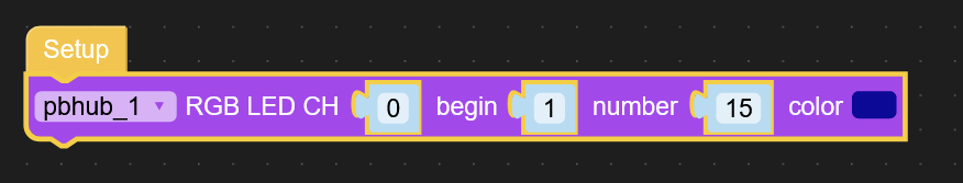

      What i tried was connecting the RGB Strip to the Pb.Hub and lighting up all 15 LEDs. But when i run the code only the first LED lights up (in the right color). All other LEDs stay off.
      When connecting the RGB Strip directly to the Atom lite, everything works fine. The following pseudo code works as expected:
      The following pseudo code only lights up the first LED (RGB Strip connected to the Pb.Hub):
      Even addressing any other LED only lights up the first LED (RGB Strip connected to the Pb.Hub):

        Hello @icemen267
        please see this thread. It's a limitation / oversight of PbHub unit v1.1
