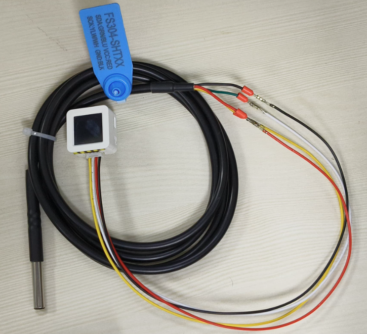

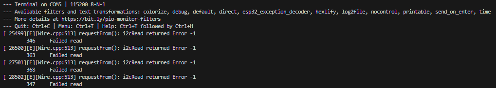

      I'm attempting to read temperature values from the SHT30 (Yanmis SHT30) sensor. However, I'm encountering an error mentioned below.
      Can someone kindly provide me with guidance or solutions to resolve the issue I'm facing?

          @surya The alternate I2C address is 45, some suppliers set it to this by default.
          Alternately you could try an sketch called an I2C scanner to see what devices are hooked up.

            Thank you, @felmue and @teastain, I will give it a try.
            • S
              Surya
              The SHT30 perfectly worked with "M5UnitENV.h". Thanks again!
              Here I am encountering another challenge: I'm attempting to read temperature data from both the SHT30 and SHT40 simultaneously. However, both sensors share the same I2C address (0x44), leading to an error. I also experimented with changing the address to 0x45, but unfortunately, it didn't resolve the issue. Any advice is greatly appreciated.
