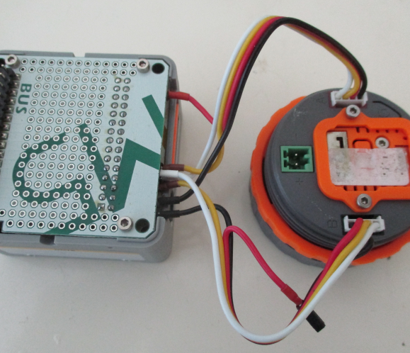

                  like @robski mentioned, M5Dial has two ports: A and B which gives you 4 GPIOs you can use. In my test I configured the GPIOs like below:
                  #define ETH_PHY_CS    1
                  #define ETH_PHY_IRQ  -1
                  #define ETH_PHY_RST  -1
                  #define ETH_SPI_SCK  13
                  #define ETH_SPI_MISO 15
                  #define ETH_SPI_MOSI  2
                  Below is how I wired M5Dial to the LAN module (using a Bus Module) and some Grove/Dupont cables.
                  Hope this helps.
                  Thanks
                  Felix
