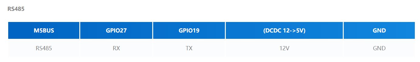

      Is build in RS-485 in to M5Tough controller supported in uiflow2?
      Can't see it in Hardware options. No Modbus blocks like when RS-485 module/unit added.

        you can use the blocks of the Modbus unit (with modified TX/RX pins) to control the internal Modbus interface.
        Please see Project Zone example M5Tough_Internal_Modbus_ACSSR_UIFlow2.0.3.

          Ok, understand, add "virtual unit" and reconfigure pins for internal extension, thx.
