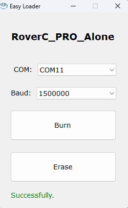

I received my M5 RoverC Pro as well as my M5Stickc Plus2 this morningI flashed my rover with Easy loader
I installed arduino IDE, launched "Running RoverC.ino" added the libraries of "M5Stickc plus2" and "M5-RoverC" plug my M5Stickc plus2 on my rover and connected via usb to my PC, in arduino IDE I have good chose the com11 port (corresponding to my M5Stickc plus 2 and Roverc pro) and "select other board" on ""M5StickCplus2"
As I have the M5StickC plus2 I changed the line #include <M5StickCPlus.h> to #include <M5StickCPlus2.h>
I run "upload" and I get the following error (see screenshot)
Thanks for your help.
