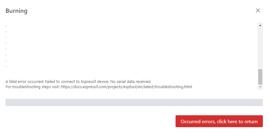

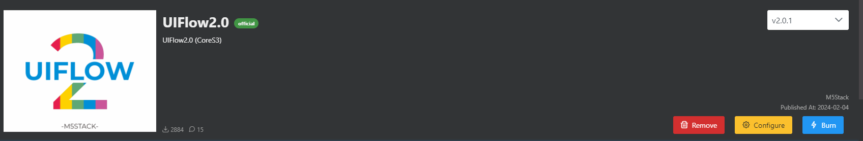

      Now I am using coreS3 and burned following UIFLOW.

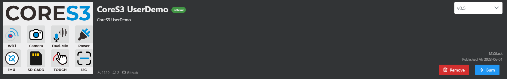

      But after burning above, I cannot revert default coreS3 setting.
      (I meant cannot burn follwoing coreS3 UserDemo)
      I guess coreS3 cannot achieve serial communication.
      Is there any way to revert?
      Thenk you.

        (Normally) You switch it on, old the boot button, plug in a USB cable and release the boot button and after 5 seconds the green light on the bottom comes on, M5 burner will report that a device is detected and then you can ERASE and then burn.
        • M
          MAFTY
          Hi ajb2k3,
          Thank you for your kind reply.
          I can do it with following process as you said.
          • Plug in USB cable
          • Hold Boot button (RST button) on coreS3 for over 5seconds
          • LED turned to be green
          • Enable to burn coreS3 UserDemo with M5Burner !!!
          Thank you again.
