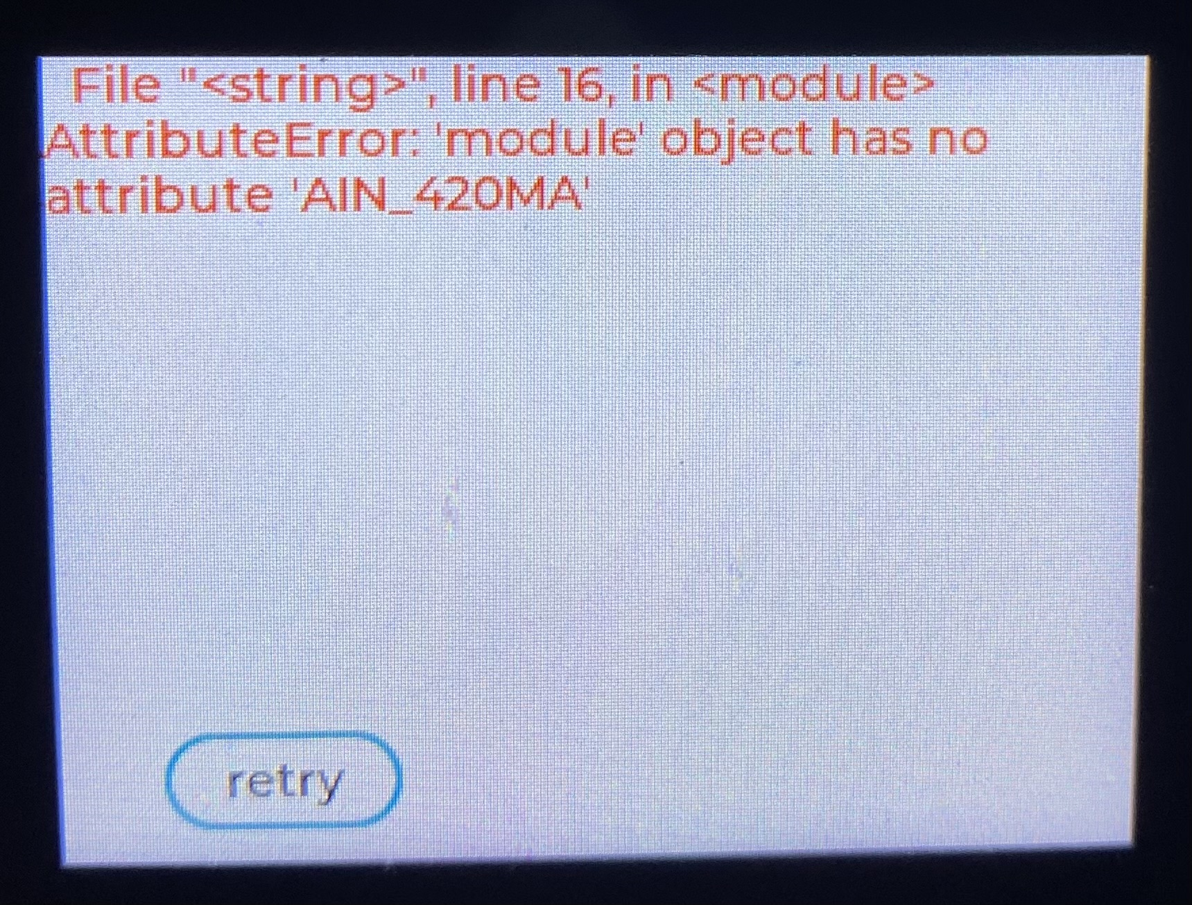

      I have got the 4 channel 4-20ma analog input module but the example code don’t work, any help would be appreciated the module is only available in web uiflow1.13 module not available in uiflow offline or web uiflow2.0
      Link to module,
      https://shop.m5stack.com/products/ain4-20ma-module-13-2
      Example code,
      https://flow.m5stack.com/?examples=module_ain420ma_demo
      Error I get after upload of example

        Worked with M5 support, and I had to download the V3 M5Burner to get the latest uifolw version onto the core2. problem solved

          I downloaded and ran the V3 M5 Burner and the AIN_420MA is still not available as a module. Is the something more I need to do?
