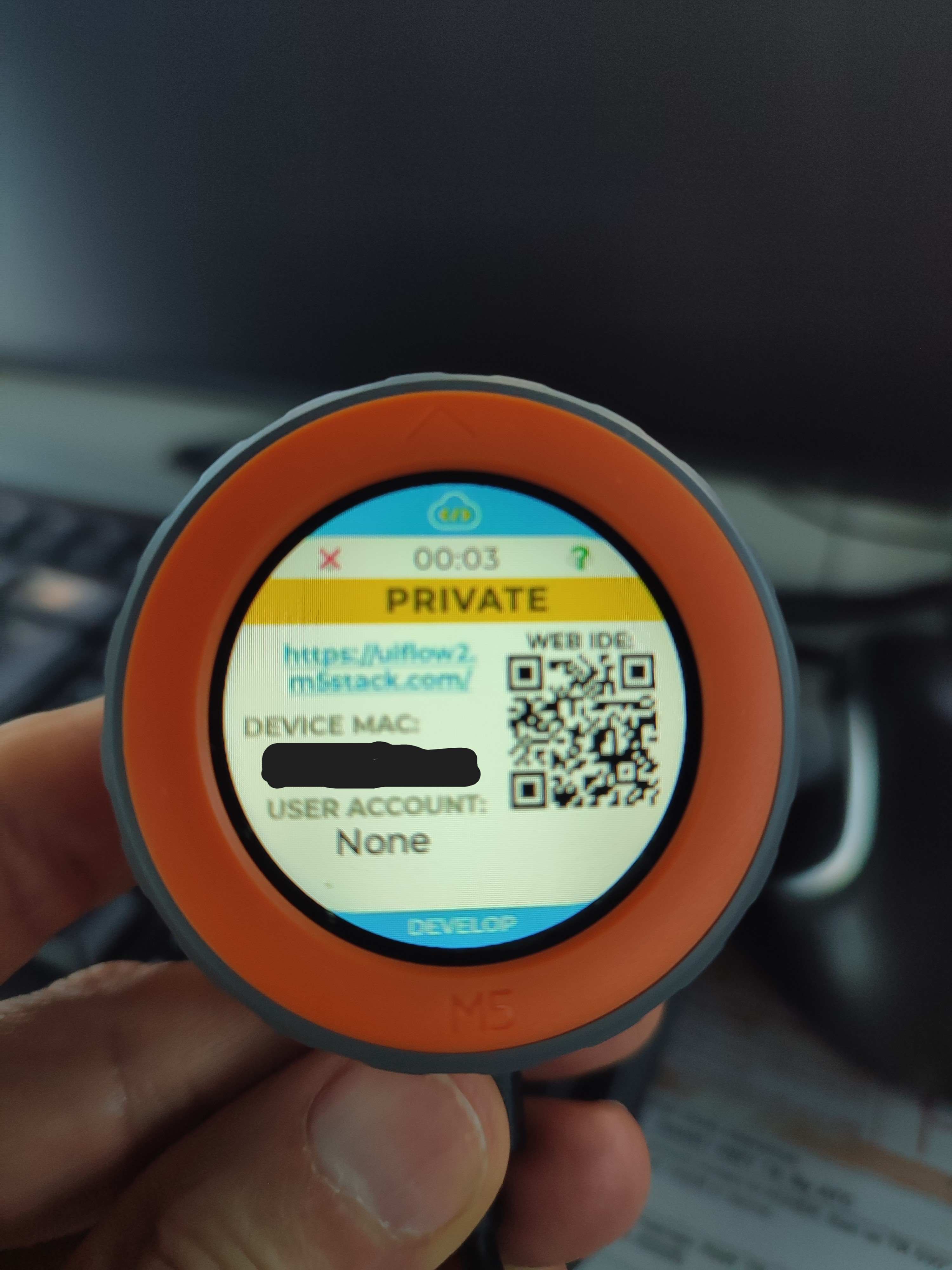

      new to M5 and this forum. Just received My M5Dial and puzzeled by all the hurdles to take before I can run my first programm. Downloaded UIFLow2, the driver and the burner. Was able to burn UIFlow to the M5Dial but not succesfull running my own Program.

      ![alt text](0_1704298635021_M5Dial.jpg image url)
      This is how it looks right now...any help appreciated!

        If you managed to burn the software then M5Burner should have asked you to register an account or log into your account. once you log in on M5Burner, the device is registered to your account and accessible via UIFlow2.

            I've used uiflow2 burner to load firmware which went in it no problem, then loaded some arduino examples ok, then suddenly uiflow2 lost ability to connect, m5burnerv3 couldn't connect too,
            finally managed to use uiflow2 burner again with back button press to load latest firmware alpha29, bizarre as previous uiflow2 burner loading alpha28 didn't required back button press at all.
