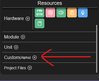

            @DaveAstator If you're still interested in this topic, you now have the "Custom" Block designer.

              @BR123456 The custom block designer seems to work OK, although it would be nice if it supported standalone functions as well as objects.
              What I'm having trouble with is figuring out how to actually import the new blocks/code into a project.
              I click on the 'Project files +' button, create and save blocks, but I see no way to import the new block into my project. V2.3.6
              What am I missing?
              B 1 Reply Last reply Reply Quote 0
              • B
                BR123456 @dlhawley
                @dlhawley I never tried making custom blocks, but i assume that after saving them you have to add them to your custom block library using the big + button.
                You can ask one of the AI chats, I use Gemini, in most cases it knows UiFlow2 pretty well.
