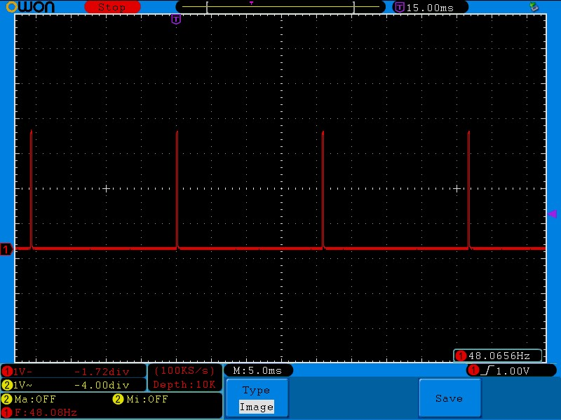

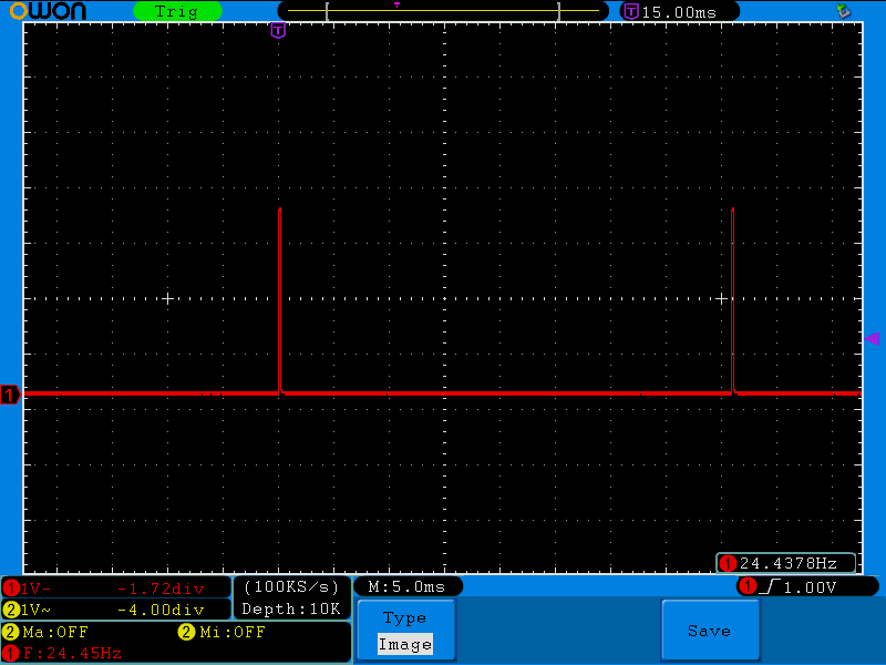

      EDIT2: I dug a little deeper, opened up the M5Paper and probed the INT pin with a scope. Apparently it's not an ESP32 issue but a GT911 issue! I guess I must be missing some configuration for it. When I'm not touching it, it pulses high at ~24Hz. When I touch it, it pulses at ~48Hz:
      not touching
      touching
      EDIT3: Aha, I finally cracked it! The scope plots made me look up the datasheet of the GT911, which states the following:
      The timing sequence for GT911 interrupt signal output (take the rising-edge triggered interrupt for example.
      The timing for falling-edge triggered interrupt is similar to this one):
      1. In standby mode, INT outputs low level.
      2. Output rising edge when any coordinate is updated.
      3. After output rising edge in step 2, INT will keep outing high level until next cycle (the cycle is configurable
        by setting Refresh_Rate). The host is supposed to finish the reading within one cycle and reset buffer status
        (0x814E) to 0.
      4. After output rising-edge in step 2, if the host fails to finish reading coordinates within one cycle, GT911 will
        output one INT pulse again instead of update coordinates even if it detects that the coordinate is updated.
      5. If the host still fails to read coordinate, GT911 will keep outputting INT pulse.
      In other words, if you don't read the coordinates from the touch screen, it will keep outputting an interrupt until you do
      So the solution ended up being to put M5.TP.flush() before going to sleep (or calling M5.TP.update() anywhere before going to sleep, which you would need to do anyway to respond to touch events).
      Case closed :-)
