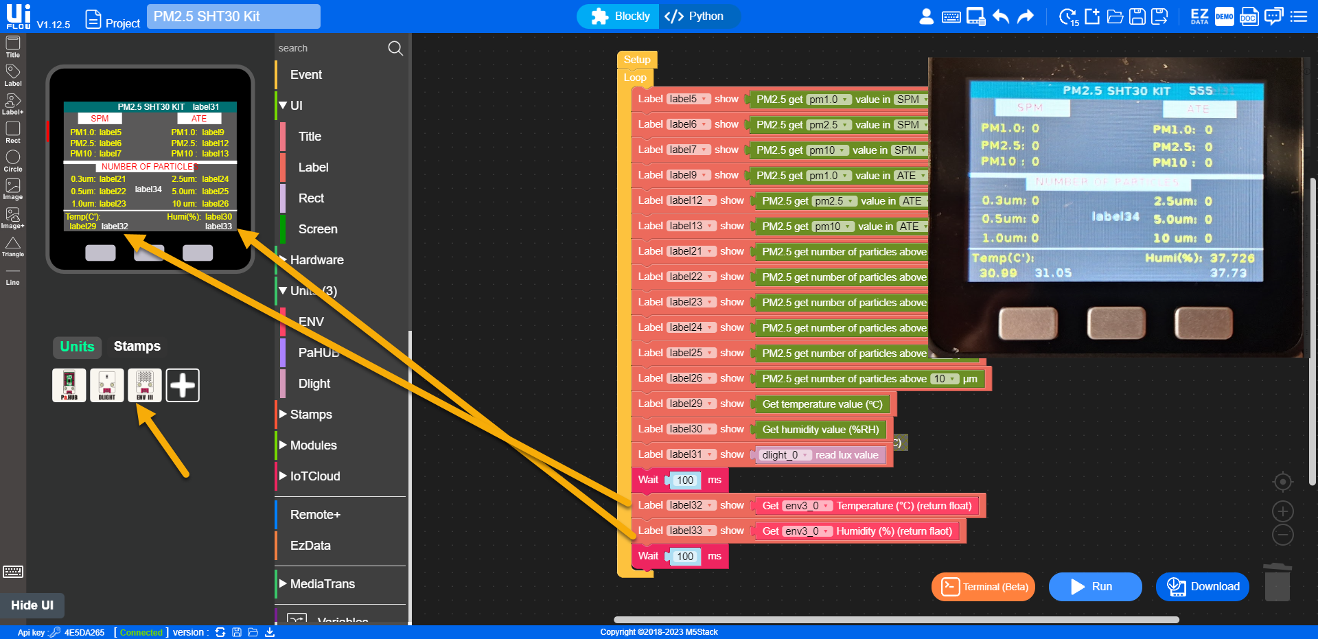

      I am testing using UIFlow , PM2.5 module, PaHub and ENV III.

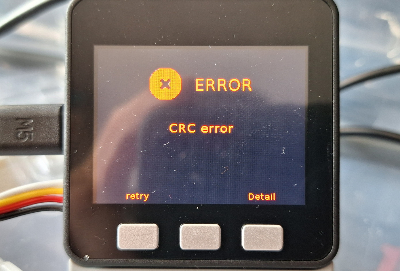

      While sometimes the app runs fine (only when the ENVIII is in PORT0 of the PaHUB), the values displayed seem to be from the built-in module.
      When I move the ENVIII sensor to another port, the app just crashes with the CRC error message
