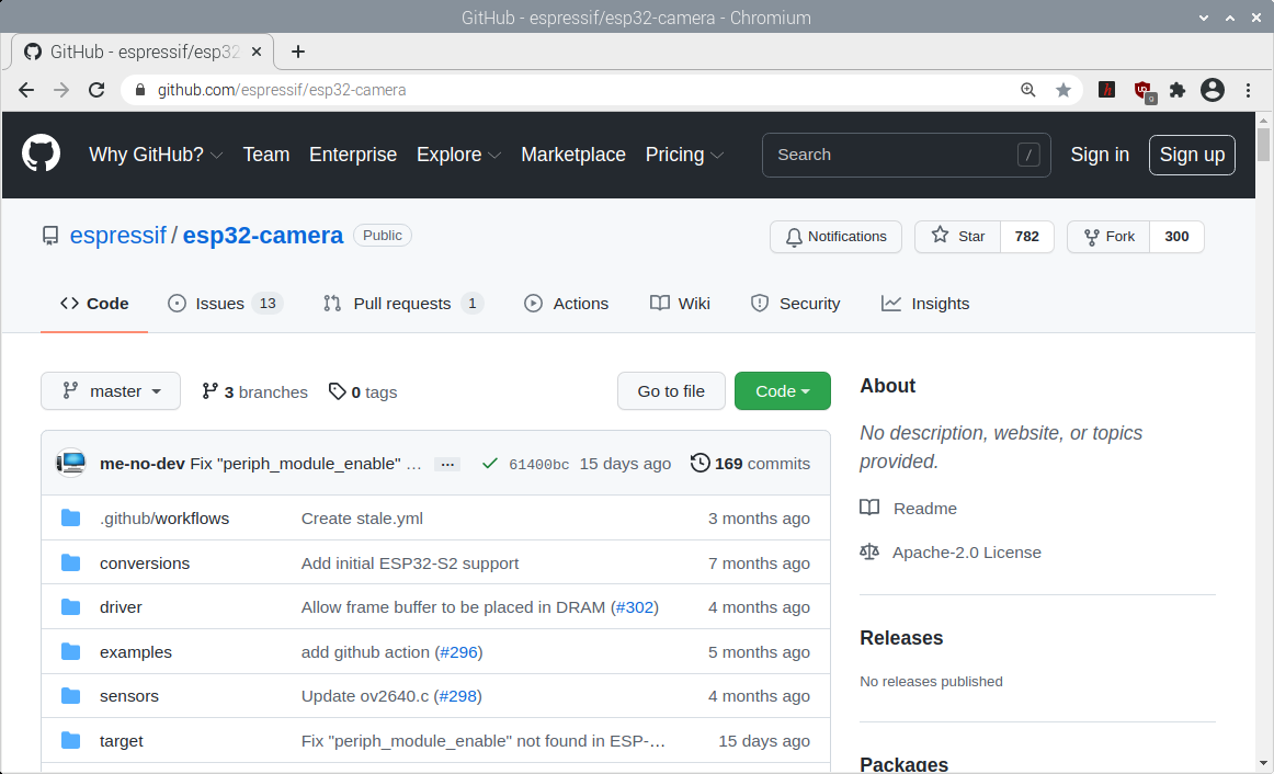

      If we want to download a current version (latest), just click on the green button and choose "Download ZIP"...
      [base picture]

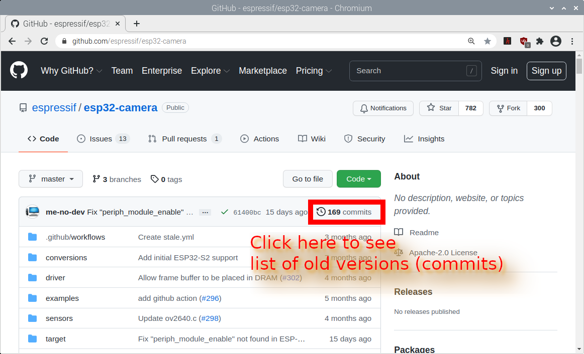

      Or, by clicking over the "nn commits", as the pictures shows:
      [base with commits-click picture]

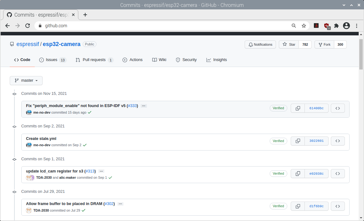

      We can see a list of dates with its commits, going back in time...
      [commits picture]
      After trying to compile with the latest (current) version and FAIL, I went back to JULY, download and IT ALSO FAIL!
      Then, I went way back to FEB/23, tested it and IT WORK OK!
