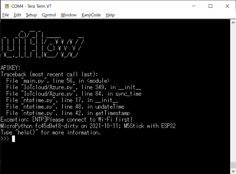

          • G
            Go.Ozeki
            I decided to use TeraTerm to refer to the COM port information.
            When an Exception occurred, the detailed information was displayed in TeraTerm.
            Don't forget to set the Baud rate to 115200 for TeraTerm!
            The attached image shows the Exception displayed when I tried to connect to IoT Central without connecting to Wi-Fi.
            Thank you for help.
            D 1 Reply Last reply Reply Quote 1
