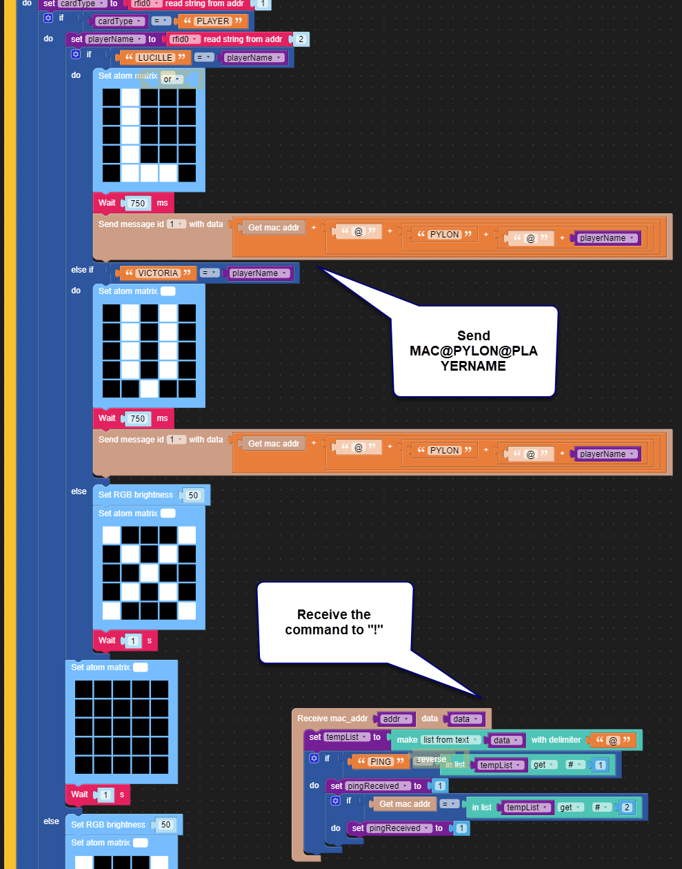

      I've started work on a project to make a sports tracker and it was working well for a bit, but now i'm a little confused on how the EspNow is working.
      Esp Setup on Controller
      Esp Setup on Check-In Points
      My Setup
      Core2 as the Brains
      Atom X 2 as the check in points

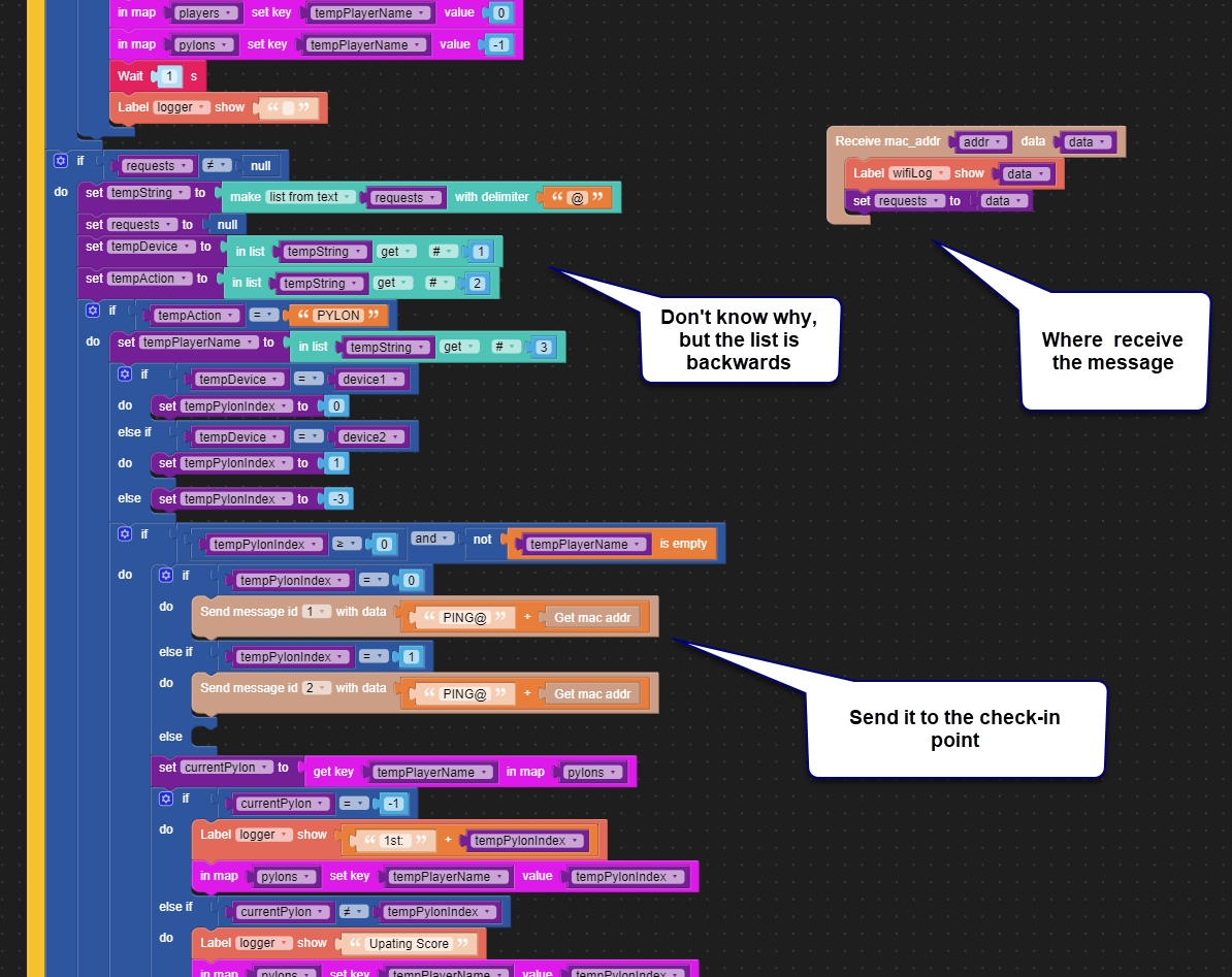

      When the player taps the RFID card against the reader at either check in point it send the device's MAC Address + "@" + "PYLON" + "@" + Players name to the hub device. Then the hub will receive the message and process it later. After it has been processed the hub send a signal to the check-in point to display a "!" symbol.
      The odd thing is, if I restart every piece and start scanning, the wrong check-in point will get the signal. Then if I scan it again, it moves to the right point, but if I move to the next point, the last check-in point receives the signal. So it is acting like a buffer and the last one is making it through.
