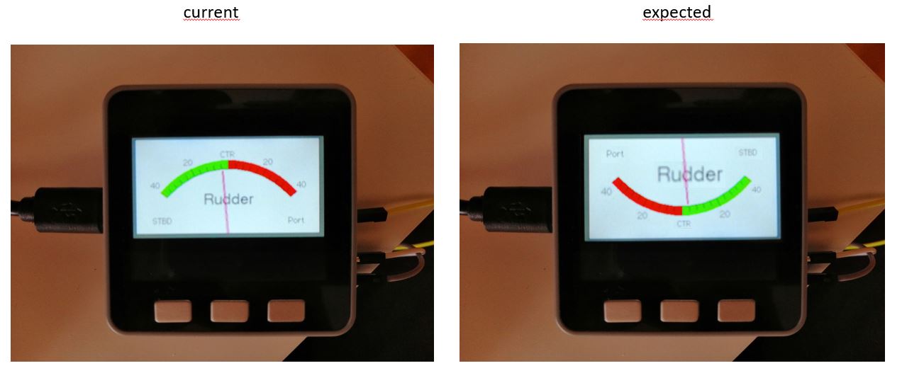

      Hello,
      this is my first post in this forum. I am pretty new to this product and not very experienced in Arduino programing. So I need your help in order to finalize my project. I do need several gauges for my boat. So I decided to try the M5Stack which allows me to display 3 different gauges on one display by simply pressing one of the three buttons. As a start I used the example "TFT_Meter_linear". So far the functionality is given. However, I would like to rotate the scale and the pointer. The command "tft.setRotation()" doesn't do it. I would appreciate if someone could give me a hint on which values I have to manipulate in order to get the desired result. I have attached a picture of the current and the required display as well as the code
      Best regards
      0_1618302186104_Rudder.JPG image url)

          Add the following to void loop ().
          void loop() {
          M5.update();
          if(M5.BtnA.wasPressed()){M5.Lcd.setRotation(3);M5.Lcd.fillScreen(TFT_BLACK);analogMeter();}
          if(M5.BtnC.wasPressed()){M5.Lcd.setRotation(1);M5.Lcd.fillScreen(TFT_BLACK);analogMeter();}
