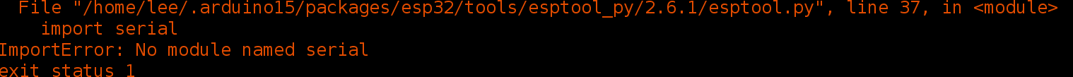

    Compile error - ImportError: No module name serial

      I get the above compile error , compiling for a M5Stick C
      I have the board manager & library installed OK. I can see all the SP32 boards & all the M5Stack examples.

      ![alt text](image 0_1588829153516_4bf9bc04-59b2-41f4-8421-ec60ba0bcd33-image.png url)

        @rexlee I assume you use Arduino IDE. What example did you compile for your M5Stick C? If it was your own code, then please upload the code so other members can take a look.

          robalstona
          Probably you need to install python serial library used by esptool.
          Could you try this command in console
          python -m pip install pyserial
