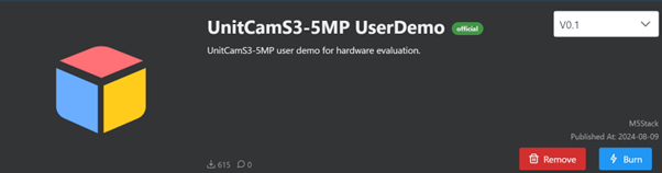

      I wish to program Unit CamS3 using MicroPython but when I flash them using this:

        This is not a Micropython firmware. You might need to configure and flash the firmware yourself: https://micropython.org/download/
