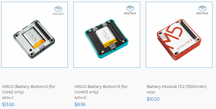

          @RPI25 said in Is it possible to use the M5GO Bottom 3 with the Tab 5:
          M5GO Bottom 3
          Hi RPI25 (and felmue)
          I am guessing (as you didn't say) that you want to use the Battery function of the M5GO to power the TAB5? Or is there another reason you wish to add the M5GO to the TAB5?
          With that said on the M5Stack Store it very specifically states that each "version" of the M5GOs are designed to work with a specific Core ONLY. I included a graphic as well:
          I did compare pinouts that were provided by Felix (thanks!) and again I am only guessing is that you are after the battery function? With that said I would simply purchase the battery (which I did do with my TAB5).
          I am curious about your project?
          Thanks-Brian
