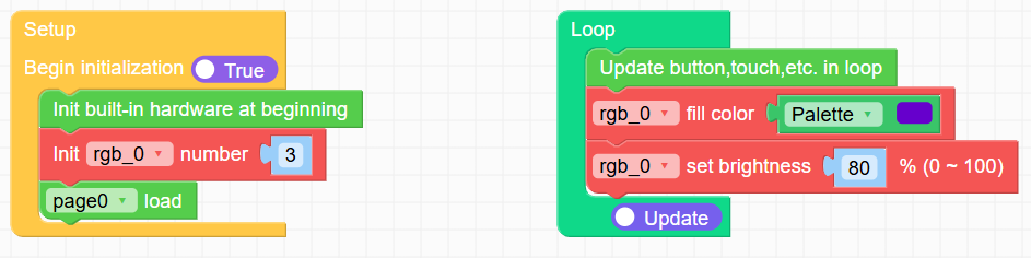

          @felmue Thanks so much for your help! I tried your example which runs fine on my Core 2 but still the RGB Unit doesn't show any light. I have tried a second one but I received no further results. I am currently trying a new way of powering the RGB Unit by importing the RGB Unit through the Unit selection menu and then using those blocks.
          But that doesn't seem to help either. I assume that in the new firmware, M5Stack hasn't removed the ability to use port A as the port for the RGB Units as I found that they could only be powered by port B in UiFlow 1. I have several other grove cables that I am going to try and then also test to see if any other units work through port A (like CardKB and ENV III) and will send any further information if you would like.

                  When you add the RGB unit did you choose port A? By default port B is selected which uses different GPIOs.
                  Also, just to make sure, you did connect the input side of the RGB unit to M5Core2 port A, yes.

                    I did select the Port A for the RGB Units, I have tried connecting it to both sides but neither work... That is the same with both RGB Units.
                    Thanks,
